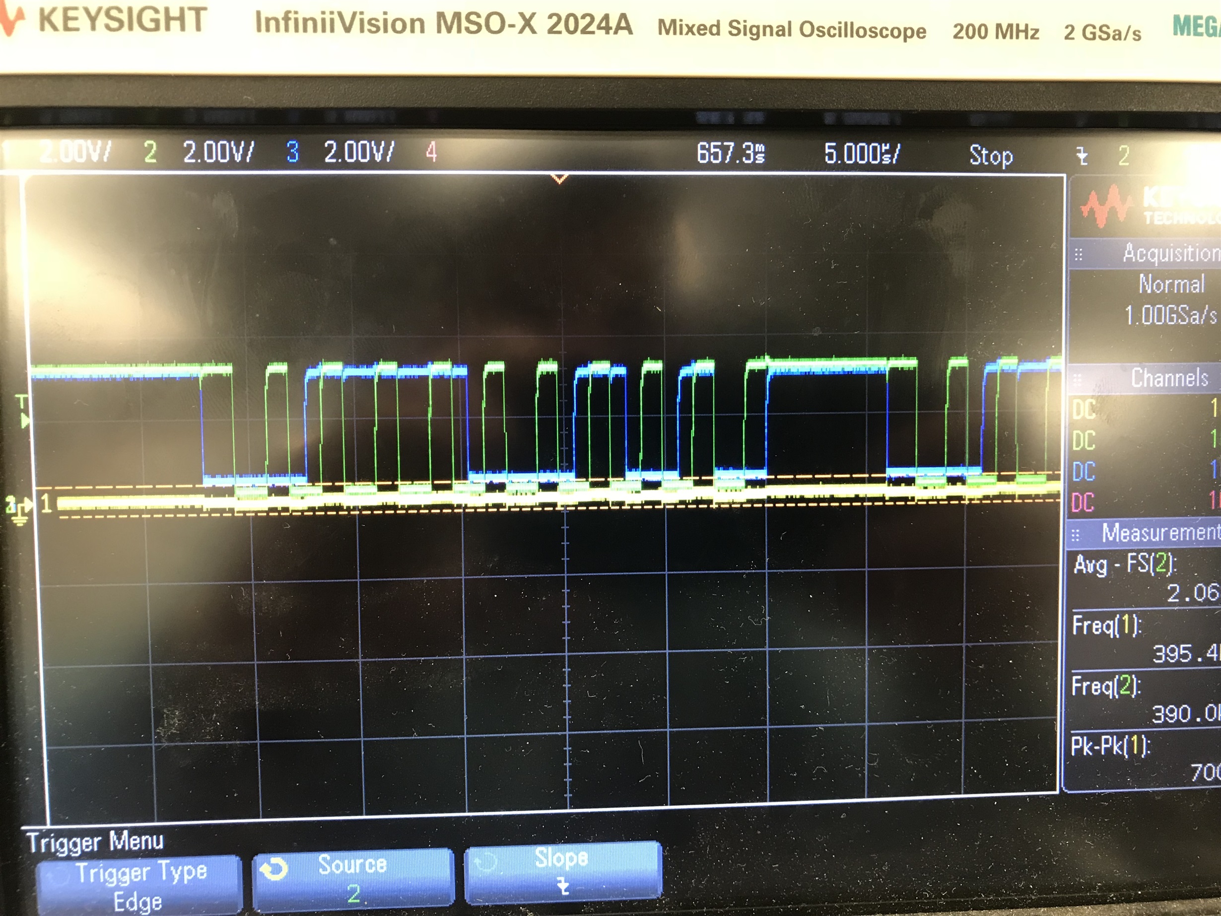

I am currently working to interface the Focal Touch Capacitive Touch Screen which has the FT5306 chip onboard and comes prepackaged. I am unable, however, to communicate with the device with my TIVA TM4C129 MCU with it. When I try to send and read data to the touch panel, I seem to be getting a NACK and am unsure as to why it that is. When I press down on the touch panel, I'm also not able to see the INT signal change meaning that I'm not sure if the touch panel is being detected correctly.
I've probed the SDA and SCL lines and observe the following manner when I begin my transmission and attempt to write to register 0x38. I've looked through the TI document at  and am still unable to understand why I am not receiving any communication with the touch controller.

  • Sorry for not including the I2C signal lines in the original post - The blue is the SDA line and the green is the SCL line.
  • Feel your pain - IIRC - I resolved a (highly) similar issue - with (your) or a touch-screen (extremely) similar.
    Your signal levels look good - yet there is (some) rounding - have you employed, "External Pull-Up Resistors" (~10K) - rather than using the MCU's (too high value) internal ones?

    • It's my sense that your scope cap would improve - if the I2C channels would be "vertically offset" and identified - which yields improved viewing.

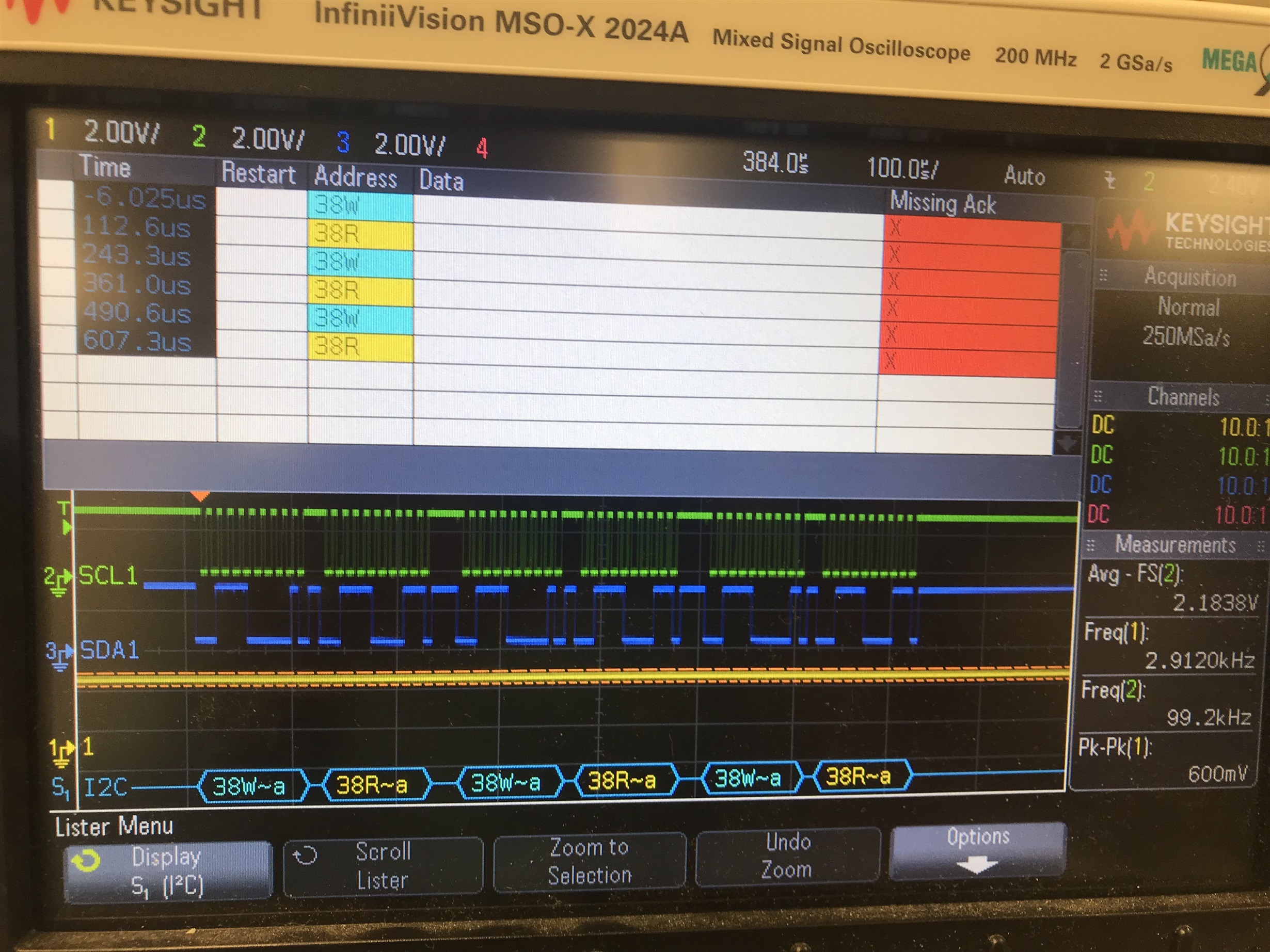

    Thank you for your quick response! Unfortunately, I am still unable to send data to the device and am continuing to get a NACK.
    - I have employed external pull-up resistors rather than using the MCU's internal ones.
    - I've triple checked my connections and confirm that they are correct.
    - I've lowered the speed to 100kHz but that didn't help.
    - I am currently using jumper wires to connect with the device.
    - I am using an external power supply to power up the touch controller so can confirm that there is enough power for the device.

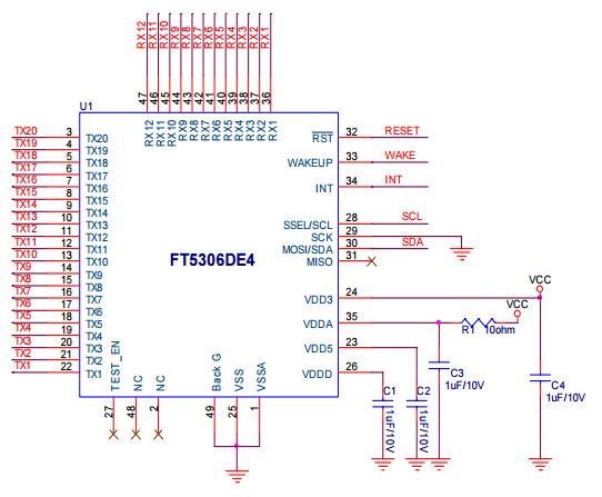

    If I had to guess anything, I think the touch controller isn't being woken up correctly and so the chip remains in Hibernate mode but I'm driving the WAKE pin high on the controller and unsure what else to do to change the power to active mode.
    Attached is the updated timing diagram of I2C serial communication:
  • Thank you - appreciated. I've not had the time to comb thru your Touch Manual - and confirm that 0x38 is indeed - the correct Slave Address.
    Your scope cap - now "normal/customary" vertically spaced overlap - is much easier to read & analyze.

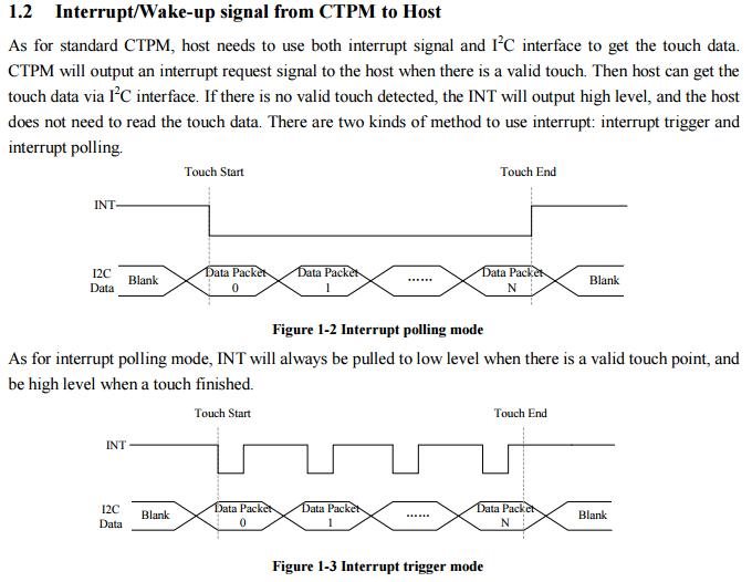

    Can you read thru the Touch Manual - and provide the Page # - which describes the: "Touch Hibernate" and also the "Interrupt on Touch?" That will save time/effort forced upon myself/others - who should remain "fresh" to best assist.
    You don't really (clearly) identify - just where - those scope probes were located - when the neat (new) scope cap was acquired. The only place that (really) counts - is right at the Touch Controller's pins - that "Last Mile" of the connection journey - is most always - the one which has failed or proves (otherwise) suspect.

    The last (bottom) reveals (your) device - but with the addition of a "Wake" Pin - which I don't recall your mentioning.   Unfortunately - w/our flight nearing - we could not discover the proper handling of "Wake."
    Items of Importance when employing the FT5306 (and "most" friends):
    • The "INT" pin is "Bi-Directional" (not that there's anything wrong w/that) - thus you must order your MCU first to OUTPUT MODE - and output a low pulse of  "0.5 to 1.0mS" duration.   Then - immediately switch that pin to INPUT MODE!
    • I wanted to "emphasize" the "INT" pin - yet  "prior to that pin's attention" - the RESET pin should be driven low for > 1mS.    And then returned to logic high.
    • Unknown is the treatment of the Wake Pin (only YOU have the datasheet) yet I'd hazard the guess - that it too - should be driven low - and 1mS appears as a "common theme."
