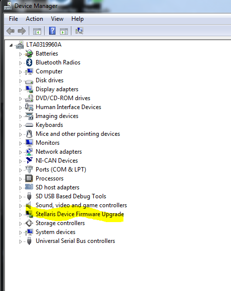

    It is neat to see a post from someone I actually know. Unfortunately I am not an expert in this area. If the device is erased, will it be recognized as "Stellaris Device Firmware Upgrade"?
  • Bob,
    Nice to hear from you. I hope all is well.
    I erased the device, and yes I see Stellaris Device Firmware Upgrade show up in device manager.
