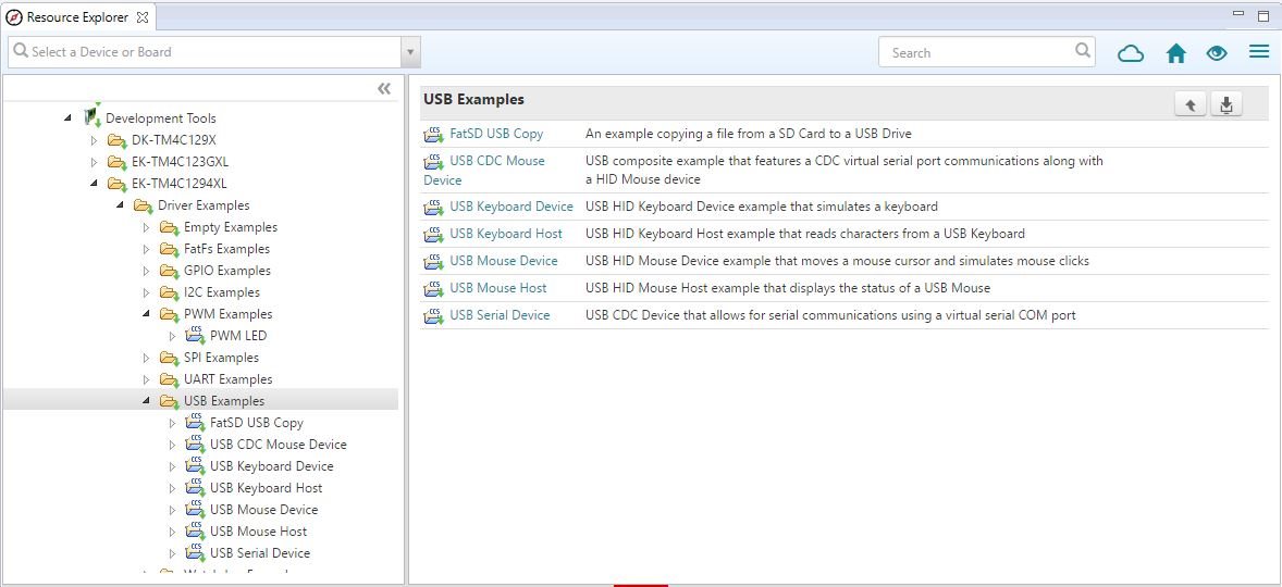

     There are several TI-RTOS USB examples. Please start with these examples as TI-RTOS has its drivers to support USB. I don't think mixing the TivaWare USB with TI-RTOS is a good idea as you may run into other problems.
  • I wanna use the otg cable as im using usb cable to power the board. What should i do to run 2 tasks simultaneously in TI-RTOS.
  • I used Ti-RTOS example of usb and tried it with my code it builds fine but in debug mode it stucks on HWI.C file on this command
