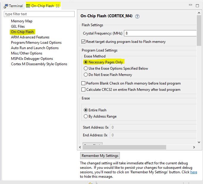

     The boot_demo1 is an application starting at address 0x4000 while the bootloader is loaded to the flash starting at address 0x0. I think what might have happened was than you you load the boot_demo1 using CCS, the CCS first erases the entire flash and thus wiping out the bootloader. By the end of the loading, only boot_demo1 appears at 0x4000 but the bootloader starting at 0x0 is gone. You can verify this by looking the memory browser window to see if the boot_demo1 is present at 0x4000 and if the bootloader at 0x0 is erased to all F's.
     With that said, to load the boot_demo1 you want to prevent CCS from erasing the entire flash which is the default when loading a new program. See below and change to the  "Necessary Pages Only" for the Erase Method.

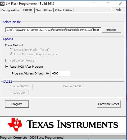

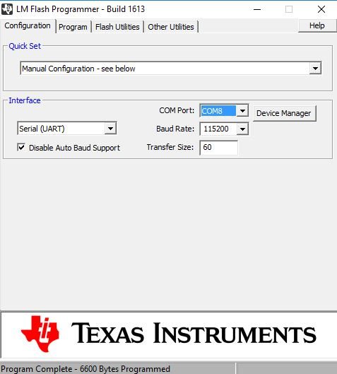

  • If you have successfully loaded the boot_demo1 then you should see the LED toggling. Or you can go to address 0x4000 in the memory browser and you should see the boot_demo1 being loaded there.
    Have you downloaded the latest TivaWare. The entire CCS project for the boot_demo1, boot_demo2 and boot_serial should all be there in the TivaWare library. In CCS, you just need to import these CCS projects and you can rebuild them anytime once they are imported to your workspace.
    Senthil Paramasivam said:
    1. Once the TM4C1294 is powered up, it will automatically load bootloader (boot_serial.out) from the flash 0x0 address and will wait for the UART communication.
     Yes. If you are using LM flash programmer then after you press the "Program" button in the Program tab, the boot_demo1.bin will be downloaded to the flash. See below images.
