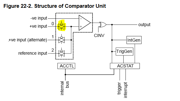

What should be done with unused analog comparator inputs C1+, C2+ input pins when external reference is provided by C0+ for all compactors?
Can these unused inputs if left floating lead to random noise on the comparator Cn- input structure? Does the comparator block ground unused Cn- pins internally when C0+ is configured to provide external +VREF threshold via GPIO port C6?
  • To avoid capacitively coupling noise across the analog pass gate, I suggest that you not configure pins for C1+ and C2+. That way there are two passgates between signals on the pin and the voltage comparator. The first is the input signal mux, and the second is the analog passgate in the analog comparator module. Then it should be safe to use these pins as GPIO or for a different peripheral. If the pins are unused, the preferred practice is to ground them.

    That is sort of the point as the pins are not being configured but are still part of the comparator block internally.
    So the +ve inputs are tristated and adjacent analog signals on the MCU package pins can not enter the IN+ input?
    Oddly adding an external 10k WPD to the C2- analog input helps reduce false triggering but C2- is most always the offender of the three OR'd MnFault sources. There is still a small amount of current flow in the last OR'd M2fault source, regardless of analog comparators XOR being configured as OD.
