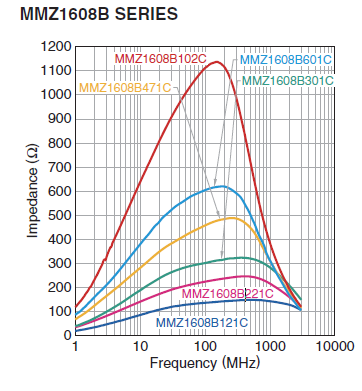

    MMZ1608 is just recently proving a good investment in our design, just wish we had put them in more places versus 0402 0R. Yet MMZ sits nicely atop 0402 pads with only marginal hangover. So far we have tested the B121C and good results were noted (samples) places where 0R were series to 3v3 LDO +5v inputs for one. The higher impedance B102C/B601C are now on order.
    B material: This type is perfectly suited for fast digital signals. By equalizing R components and X components that beads possess at a frequency of 5MHz, it is able to suppress overshooting, undershooting and ringing of fast digital signals.
