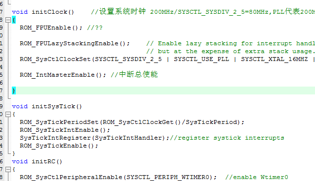

I want to measure 4ch PWM using  capture mode of timer.Here is my configuration:
But somehow, I can't enter into the interrupt.Did I make some mistakes?
  • Do you have a call to "ROM_IntMasterEnable();" somewhere else in your code?
  • Yes,I write it before initRC() after initClock().

  •  Yes,of course.
  • I FIND IT, I FORGET TO ADD RCINIT TO INITALL()........

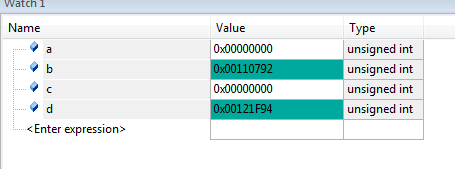

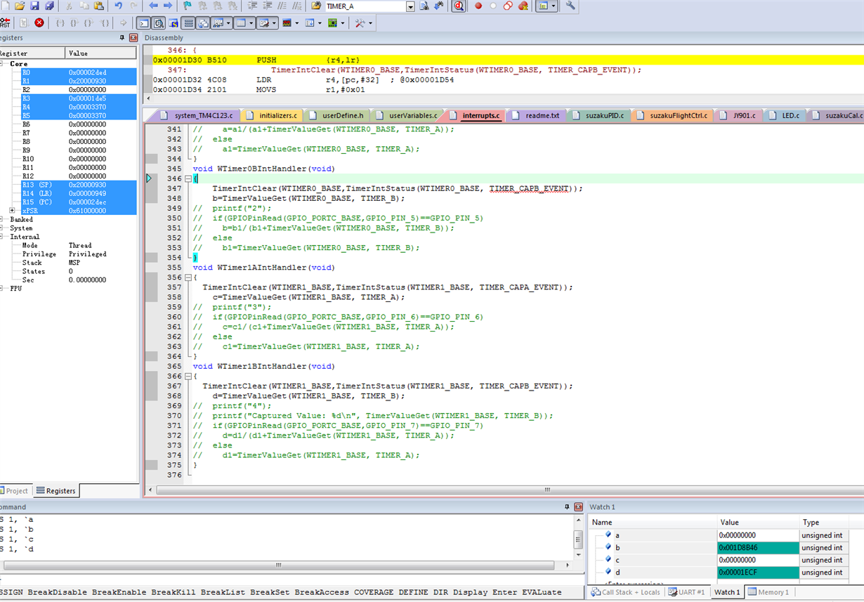

    After some modification, I have got some data.However,only  Timer0B and Timer1B displayed(through the debug watch window).Here are  screenshots:
    As you can see,the 2ch data are unstable. but the input which I can insure is 4ch same 7% 50hz PWM from the model airplane receiver.
    I still don't know where is my fault and I can't get the correct data....

  • Instead of calling TimerEnable separately for each half of a timer, you should call it once and use "TIMER_BOTH"
    Instead of:
        ROM_TimerEnable(WTIMER0_BASE, TIMER_A);
        ROM_TimerEnable(WTIMER0_BASE, TIMER_B);
        ROM_TimerEnable(WTIMER1_BASE, TIMER_A);
        ROM_TimerEnable(WTIMER1_BASE, TIMER_B);
    Use:
        ROM_TimerEnable(WTIMER0_BASE, TIMER_BOTH);
        ROM_TimerEnable(WTIMER1_BASE, TIMER_BOTH);
  • Similarly, your calls to TimerConfigure should be one call for each timer.
    Instead of:
        ROM_TimerConfigure(WTIMER0_BASE, TIMER_CFG_SPLIT_PAIR | TIMER_CFG_A_CAP_TIME_UP );
        ROM_TimerConfigure(WTIMER0_BASE, TIMER_CFG_SPLIT_PAIR | TIMER_CFG_B_CAP_TIME_UP );
        ROM_TimerConfigure(WTIMER1_BASE, TIMER_CFG_SPLIT_PAIR | TIMER_CFG_A_CAP_TIME_UP );
        ROM_TimerConfigure(WTIMER1_BASE, TIMER_CFG_SPLIT_PAIR | TIMER_CFG_B_CAP_TIME_UP );
    Use:
        ROM_TimerConfigure(WTIMER0_BASE, TIMER_CFG_SPLIT_PAIR | TIMER_CFG_A_CAP_TIME_UP | TIMER_CFG_B_CAP_TIME_UP);
        ROM_TimerConfigure(WTIMER1_BASE, TIMER_CFG_SPLIT_PAIR | TIMER_CFG_A_CAP_TIME_UP | TIMER_CFG_B_CAP_TIME_UP);

  • Hi CB1,
    It is the first scenario. The second call overwrites the first.
