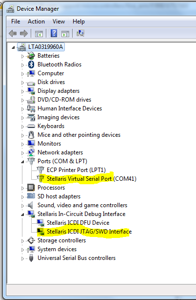

When you connect do you see Stellaris ICDI in your device manager?

Just tried a different computer (Win 7) and I get the same message. Cannot initialize target.
Can you find out if this board was working for the previous user? Could it have been damaged and then just put on the shelf? Do you have access to a different board to try?
I took the board to one of the previous two users and he tried to connect on his computer but has the same issue, unable to initialize target. I am waiting to hear from the other user.
We only have the one board.
