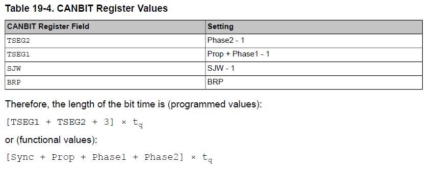

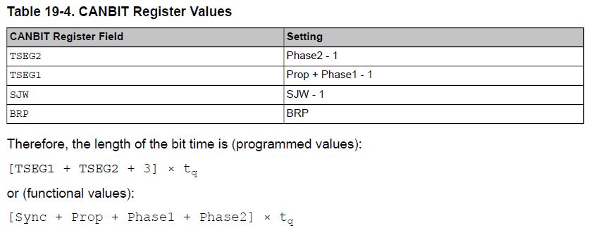

Hi all,
I want to ask this question again, please.
e2e.ti.com/.../350758
     I don't think the source code is wrong. I think perhaps the variable name could have been defined as ui32PropPhase1Seg rather than ui32SyncPropPhase1Seg because the Sync field is a segment that is always equal to 1 quanta. This is an implied quanta. The hardware will always account for the 1 quanta Sync field when adjusting the nominal bit timing.
    Here is what is shown in the datasheet. Please note that the register field TSEG1, TSEG2 are programmed to a numerical value that is one less than its functional value. If you look at the first equation, the bit time is equal to (TSEG1 + TSEG2 + 3). * tq. You might ask where the 3 is coming from. Since the programmed value is one less than the functional value, the actual functional (Prog+Phase1+Phase2) will be two more than (TSEG1+TSEG2). This accounts for 2. Where is the other 1? That is to account for the Sync which is implied.
