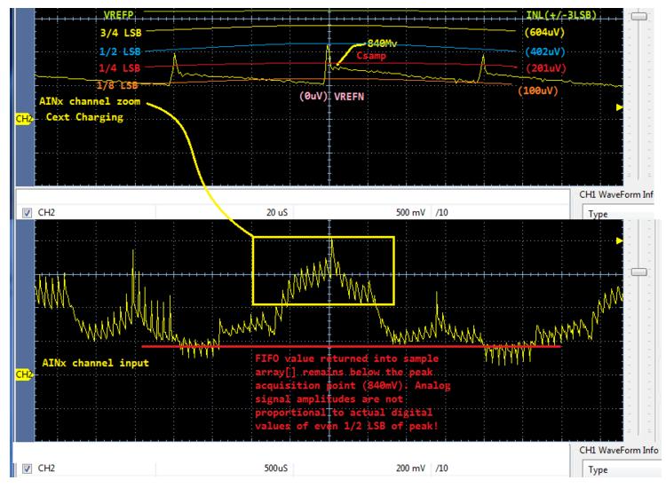

Why is TM4C1294 SAR unable to follow this signal to scale or equal vertical voltage ramp (elevation) since INA240 output was developed to work with SAR ADC?
After more testing of signal via several different analog pulse profiles again only reveals TM41294 ADC can not lock onto the top acquisition points to create a monotonic rise digital representation of current rising. The SAR embedded in MCU always chooses to acquisition the pulsing signal near the horizontal center and mostly produces bloated representations of the original signal.
It appears there is an issue with ADC to properly sample a ramping vertical growing signal in order to build stepping monotonic linear digital values (rise/fall) from a pulsing signal. All the Rs impedance rules followed yet ADC can not acquisition from the top of full scale (VREP) down or even the bottom (VREFN) up. Sure if we stick pure DC current into AINx channel CADC will stay charged during Cext recovery periods so 475nf Cext shown below (Table1) is a band aid to being with. The INA open loop gain into ANIx is not being properly handled by ADC0 for what ever reasons.  We need to figure out what and why then get it fixed like any other engine, when it fails we take it to a mechanic to fix it, do we not?
Otherwise the entire INA current monitor narrative has been falsified upon the community suggesting any SAR ADC can produce digital integer representations of current (values) from a ramping analog signal without SW trickery being involved. I truly do not want to believe such occurs at TI and they make every best effort to ensure all SAR devices are compatible with a flagship device. Seemingly there is something wrong with the TM4C1294 SAR ADC not being able to correctly interface (ASIS) with the very same companies current monitor. Might something have been left out of the picture a customer might require to make a proper judgment call? Perhaps similar testing INA240 experimental PCB in the LAB with EK-TM4C294XL will verify this conversion thread has merit?
That said, once again why would the ADC not be able to properly acquisition the signal below, what is wrong with it? What attributes must pulsing signal have for proper acquisition to achieve at least 1/2 LSB resolution (microvolt) or even 1/4 LSB near (Csamp) being industry typical SAR acquisition standard? Is it possible TM4C1294 ADC may not properly work with INA240? Why would TI not test the INA240 on several different MCU to ensure it being fully SAR compatible with PWM intended modulation? Why would TI expect the customer to modify the INA240 output to work with TM4C1294 SAR and not notify the community of such an expectation even in WiKi documents?
Point is these questions indicate some kind of ADC anomaly must have flown under TI radar screen. The INA240 should not be any problem for TM4C1294 SAR to reproduce the intended digital results from an similar frequency periodic analog input signal.

    I am not sure I understand your point. If you are not getting the expected results, but you have designed for sufficient settling time, then the problem is somewhere else.
    What is the maximum value you sampled? What is your sample rate? Remember that at 3.3V reference, one LSB is 0.8mV. Are you using an external reference or an internal reference? Then maximum total error for an unadjusted internal reference is +/- 30 lsb or 24mV.

    The point is the TM4C can not lock on to the acquisition points (Csamp) shown in capture nor produce a scaled LSB to MSB representation of the analog voltage as it rises to any peak under 3.1v full scale. Even if we bias the 240 output (1.65v) ADC can not sample those same acquisition points into a scaled solution that represents the digital current measured in two ways. First by digital readout, 2nd by GUI scope widget with rising slope. This issue can't be the result of +/-30.0 LSB error since converter does produce a copy of the original input signal though greatly reduced in scale. The odd part is PWM duty cycle produces ratchet steps for the ADC not locking onto rising slow peaks above the last acquisition point in order to form a monotonic increase in amplitude. That seems to infer Charge sharing is being dumped after each conversion. Hercules has a register to force that very dump.
    Tried both REF2033 being far to noisy, currently using internal VREF. Anyway SAR acquisition conversion is detected in microvolts not millivolts. So Figure 15-9 first vertical mark 1/4 VREF 825mv, everything to the left of that 1st mark 825mv down to 0mv being 0LSB. That 1/4 VREF is the converters digital output scale, not sample scale (microvolts) relative to each acquisition point inside our full scale. That is why all the graphs in Hercules PDF indicate (uV) on the left side to explain 1/4 LSB resolution is very fine. Acquisition 1/4 LSB resolution occurs as seen by the analog side of converter during sampling, not the AINx analog channel voltage or the VREF (millivolt) digital scale. Hercules PDF shows us sampling happens in much smaller baby steps of the converter not directly related to VREFP-N, fact the TM4C1294 datasheet seems to omit.
    It seems TM4C SAR the entire analog signal is being directly passed into the converter and only scaled down (compressed) relative to REF and not being acquisitioned relative to VREFP in full scale of Fig15-9. Seemingly that is why there is no top/bottom point of reference for digital output relative to VREF for a single ended channel input when the analog signal has fast periodic rise/fall times. Now if we rectify that same signal it may very well properly acquisition the slower rise times. Table 1 shows our signal is settling a bit slower but there is plenty of slew in the signal up to 80us for Cext charge sharing with CADC.

  • Both the 'drawings' and 'method' presented here - appear to me - 'outside' normal/customary  'ADC Evaluation Techniques.'
    I (remain) unclear as to the 'true source' of (both) the 'Scope-Cap-Like' images - earlier presented.    Please (accept) that if you've (briefly & earlier) described the 'creation of these images' - there exist (now) 3 separate threads - all focused upon this issue!      (forcing such a 'labor intensive search' upon your 'would-be' helpers - proves not to your 'best interest.' )
    For clarity - I've copied them (from the initial post - this thread) - and present  here.
    Now - I (suspect) but do not 'know' - if these images are 'True Scope Caps' - and even if (having started as such) they have not gone thru (some form) of post-processing and/or manipulation.    Might you detail?
    What I believe to be (very) 'Missing' - is the, 'Pure (unmodified/processed Scope-Cap of the 'Test Analog Signal' - captured as close as possible to the MCU's ADC pin - and w/scope Probe's GND Lead removed!   (I will illustrate the proper means to conduct such 'Probe Modification' later - w/in this post.)

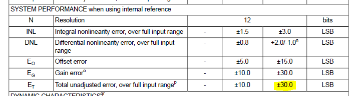

    Agree and that is why this thread is ongoing until the nitty gritty of the issue is resolved. Likewise 475n Cext would push INA240 open loop gain into extremely higher error %, more than it is already by the distorted gain peaks in capture. The 22n Cext of posted capture shows us settling time is not causing the SAR to drop shared or CADC charge hold. Seemingly the ADC converter is not moving LSB bits into MSB circular positions after each cycle group (80us) required to elevate digital results relative VREFP 3v3 full scale of the analog signal.
    Even if there was 30% error, the missing left shift of FIFO bits on the digital side of converter still fails and instead dumps VREFP samples all the way down to VREFN each cycle group time.  Seemingly that is not correct SAR converter behavior even if channel cross talk was in the mix. Perhaps this also explains why pure analog DC signals digital array[] 10ths position (mV) hunts cycles at high speed 0-9 never to fully stabilize 2x averaging. The SAR converter seems to dump CADC charge to ground each cycle group time during Cext recovery period no matter if NSH matches Rs impedance.
    Have to wonder at this point if perhaps hardware averaging adds some kind of errata upon converter, e.g. FIFO not properly left shifting LSB results into MSB bit positions after each cycle group time? That necessary shifting only seems to occur if the analog voltage side of ANIx spikes very high but only for 1-2 cycle groups of acquisition does that left shift occur. So the circular FIFO is not acting circular as it relates to the converter handshake of LSB into MSB cycle times, hardware averaging or otherwise being functional at all for any A/D conversions.
    I updated the signal capture 1st post to indicate what the analog converter sees each 80us group time. I realize microvolt acquisition is very different from Fig.15.9 (generic) presenting only the millivolts scale from a digital results perspective 0-4096.  Yet that is not how the SAR converter acquisitions in ratios (1000:1) in the 3v3 VREFP digital perspective of analog settling being correct.

    The ADC clock is set for 30MHz 2MSPS and behaved the same 16Mhz ADC clock. Circular FIFO must keep pace with digital converter << LSB bits into MSB bit positions.
    Logically serial FIFO clocking requires 16x ADC clock 30MHz order to maintain synchronous pace with digital converters acquisitions (2MSPS), that logic requires PLL=480MHz. This is a conundrum as MOSC=25MHz and PSYDIV +N pre-divides PLL block 240MHz, according to recent discussions of PLL block issues.
    Like wise 16MHz ADC clock (1MSPS) rate the required FIFO serial clock 256MHz actual VCO speed falls below the synchronous speed of digital converter, so we had same failing conversions. We would settle for conversion results from PLL=480MHz and the FIFO serial clock rate of ADC0/1 modules clock being 30MHz .
    This issue was a gut feeling after Charles recently discovered PLL block VCO was running half speed. Sure seems clocking could be the fish that got away last year, now with a hook in its mouth. At least clocking is an avenue to try and make some changes so the FIFO speed matches the converters clock rate of 30MHZ.
    How can ADC0 FIFO serial clock be changed from 240MHz for it run at full speed of 480MHz and keep synchronous to the digital converter?
