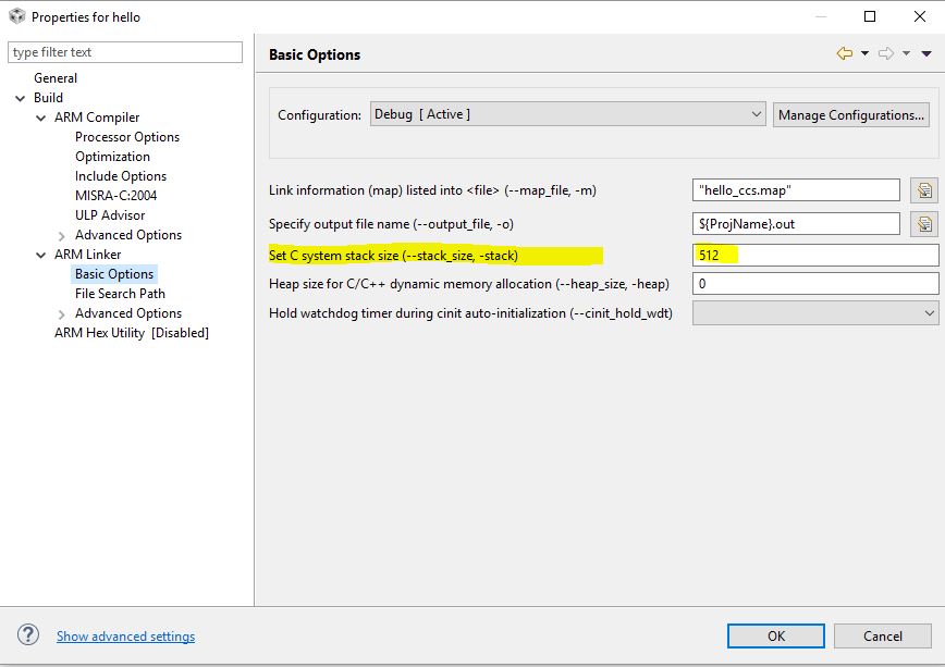

  • I tried to play with the stack size and encountered some VERY strange behavior.
    The original value was: 100
    At first I changed the size to 512 like in the picture and nothing good came out of that...the program got stuck at MPU6050Init (even earlier than before).
    Then I changed the stack size to to 90 - this got the program to get stuck at the same point as with 100 (at the ReadModifyWrite function - which is further than I got with 512).
    Afterwards, I changed it to 150 - with this value ReadModifyWrite works correctly.
    I ran ~10 tests per stack size (100, 90, 512, 150) and the point at which the program gets stuck is 100% consistent.
    As if there's a stack size "sweet-spot" and it's 150 (!!!!!!!!!)

    We have erratic behavior characterized by a stack size "sweet spot" (150 - at which the code doesn't freeze where it usually does).
    And we also have the ARM pulling the SCL low (regardless of stack size) after finishing the MPU6050Init transaction.
    I'm really clueless here...
    Perhaps it has something to do with the fact that some variables are declared outside of the main function ??
    First of all, I don't know why 512 stack size does not work while 150 will work. It does not make sense to me. I will suggest you use 1024. But if you think 150 will work all the time then stick with it. If you started with 90 then it is really too small the stack size to use for some of the APIs.
    You said after the MPU6050Init is called the SCL will stay low. However, when your code continues to the ReadModifyWrite the transaction will still continue, is this correct?
  • "You said after the MPU6050Init is called the SCL will stay low. However, when your code continues to the ReadModifyWrite the transaction will still continue, is this correct?"

  • When you have a complicated API such that it calls functions and some of these functions can subsequently call other functions, each function call is a context switch for which the current context (i.e. registers) need to be pushed onto the stack. If you declare local variable inside a function then that will also use the stack. The amount of stack that is needed is application dependent. Some tools such as TI-RTOS's ROV can analyze the real usage of the stack compared to the amount you allocated. The program will crash when the program uses more than the allocated stack as indicated as a stack overflow fault. Again, how much stack is needed is application dependent. As far as I know, all TivaWare examples use at least 256 bytes for small examples. Some more complicated examples reserve 512 or more. 90 as you used initially is just too small especially you are using the sensorlib APIs. Here are some links talking about stack estimation.
    stackoverflow.com/.../stack-size-estimation.
    embeddedgurus.com/.../
    So with enough stack (150 you later use) you said the ReadModifyWrite will work after the MPU6050Init . You observe the SCL being low when you F6 over the MPU6050Init and then stop the CPU, correct? This means the master is still owning the I2C bus. It is waiting to continue the next transaction. I think this is a normal behavior. Once the ReadModifyWrite is called it will continue with the next transaction. Perhaps I should ask the question in another way. If you don't put any breakpoint or single-step and just let it run free, does it proceed to the end and if the master has sent all the intended data to the slave? If yes, then I think it is working properly.
  • But why doesn't it work when I change the stack size to a larger value -512 for example ?
  • Did you free-run your code exactly the same way with different stack sizes? I can't understand why a larger stack size will fault while a smaller one does not. If the program crashes with 512 stack size then use the app note I refer to debug the source of the fault. Perhaps with 512 stack size it faults for a different reason, not stack overflow.

  • Good news.
    I changed the stack size to 1024 and ran the code free without breakpoints.
    I see I2C transactions on the oscilloscope so it's no longer stuck...
    So the problem (if there was any) is solved by making the stack larger as you suggested - thanks!
    But I still don't understand why my code breaks when I run it step by step using F6.
    Can you suggest a specific scenario that will induce such a bug.
  • When you do F6 you are in single stepping mode. Each time you hit F6, the CPU runs some code and then halts. The CPU can be halted for hours until you hit F6 again. This will be a different operating environment compared to CPU in free run mode where interrupts can occur in which more context switching are happening. The context switches will involve pushing/saving the contexts to the stack which will use additional stack memory.

  • shai kon said:
    But this isn't my case - In my case free running the code doesn't cause an error while using F6 does.
    I think the code requires handling an interrupt to be able to run.
    The default CCS behaviour is to disable interrupts while stepping, but not when free running. That can cause stepping through code which requires interrupts to "hang".
    If you untick the option to "Disable interrupt while source stepping" (see Program/Memory Load Options) does that allow the code to run when source stepping?
  • Thanks!
    I unchecked it and it works now when source stepping.
    Is there a good reason to disable interrupts while debugging ?
    If you had an enabled interrupt such as a timer then when trying to step with enabled interrupts you could find the program keeps stepping into the interrupt handler (see the reply from Britta in Compiler/MSP430G2955: GIE is disabled automatically when step debugging - while the referenced thread is for a MSP430 device believe the same is true for a Cortex-M4 based Tiva device).
