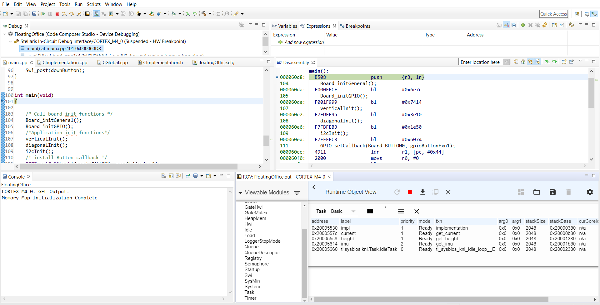

Below is the screen shot of the ROV:
when debugger in main():
After the line in get_imu() task
signal.writeRegister(i2c,0x6B, 0x80);

    So what is the problem? After you take the interrupt and the semaphore_post is executed, what happened to the get_imu? Didn't it run the signal.readRegister?
  • Hi  Charles,
    If my understanding is not wrong.
    1.Here for my project I'm using Static way of configuration.All the task are ready to run when BIOS_Init(); is called. So before calling the  main() Tasks are ready to run is it?
    2.
    void taskfxn(){
    /*Prolog*/
    while(1){
    semaphore_pend();
    /*Epilog*/
    In the above pseudo code  prolog would have been ran before its wait for semaphore. Comparing the above code to my code I'm going into blocked state when i'm in a "prolog" part of the code not in the while(1) part of the code. Before posting the semaphore  get_imu task is going into blocked state and remaining tasks into terminated states.
    While debugging I came to know that  I2C_transfer(handle, &i2cTransaction) in writeRegister() is creating this problem. Can you help me in this.
