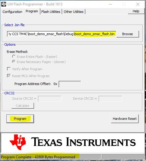

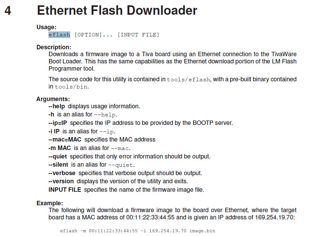

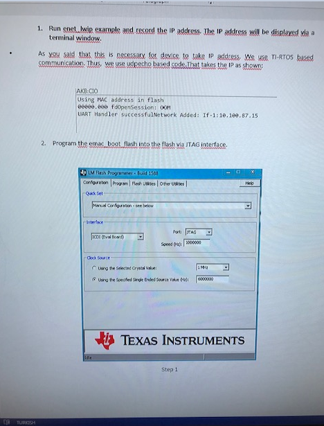

In our Project we want to update software by means of TCP. Initially, I create a tcp server side and with the help of TCP client application I want to install the choosen bin file. Subsequently, at the receiver side, I created the following function image to program flash for this purpose. Here, BIN_START_ADDR 0x4000 as I read from the Ethernet Update forums.I can not update the image. Is there any missing points or am I doing something wrong? We can not prefer to use LM Flash Progmmer. It has to be updated by code.
