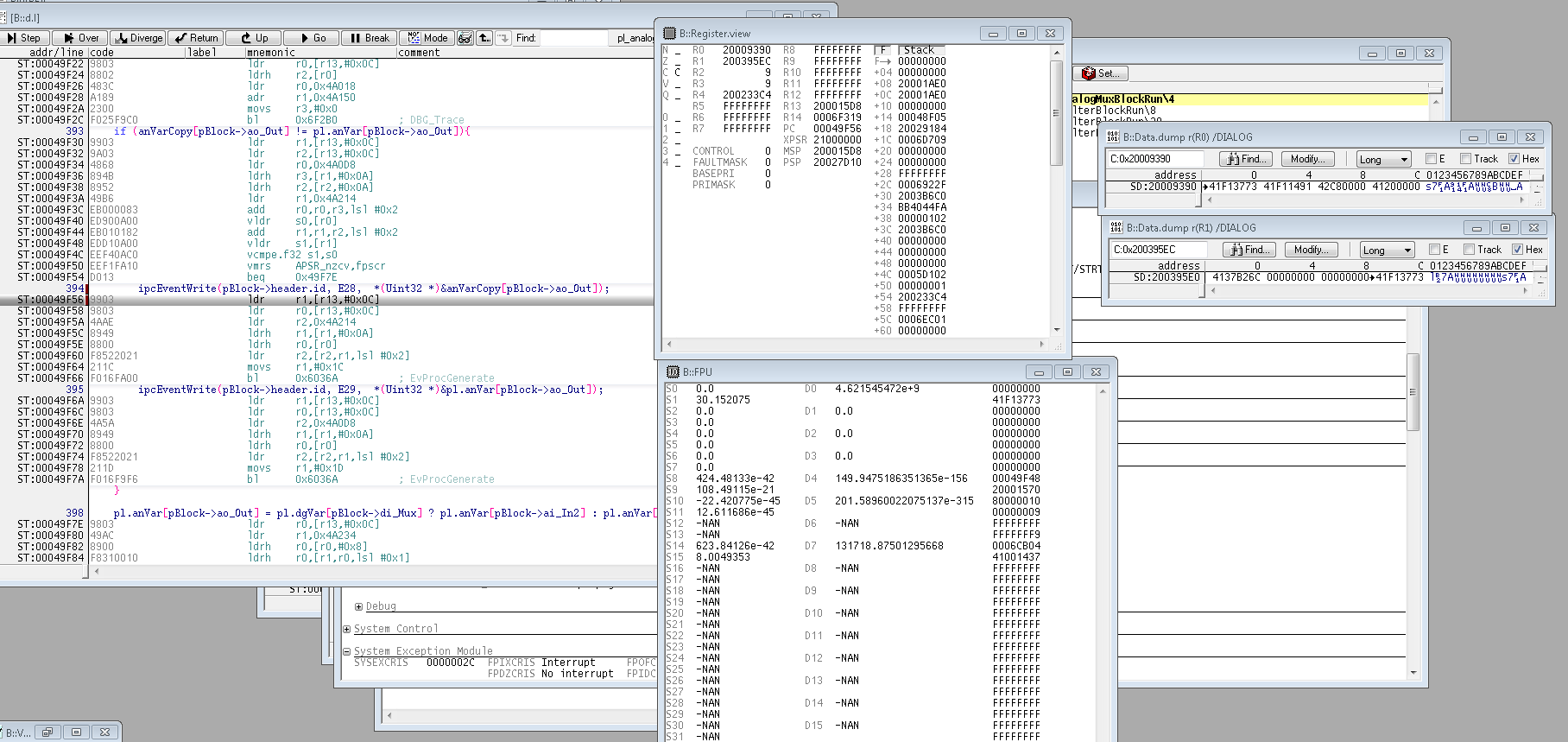

Hello all,
I'm using FPU in a SWI context (priority 15). When doing a comparison between 2 floats always expected to be equal sometime (about one over some million) I get comparison fail.
Placing a hw breakpoint shows that S0, and sometime also S1 report uncorrect value.
I've attached a screenshot where CPU is halted after comparison fails.
There S0 and S1 are loaded from addresses contained in R0 and R1, both locations contain the correct values, 30.152075 that is 0x41F13773. However, in S0 now I see 0 which is the reason breakpoint is hit.
By tracing flow with some homemade ram logger I see that problem occurs only if this SWI function is interrupted by a HWI, that I would consider not using floating point unit.

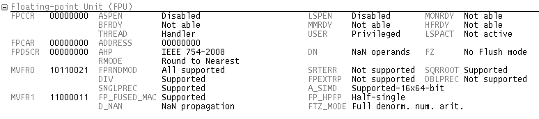

    When bk is hit, and also in any other moment, the FPCCR register shows ASPEN bit clear, should it be set or it's OK?
    I've checked the disassembly of ti_sysbios_family_arm_m3_Hwi_dispatch__I and conditional instructions under __TI_VFP_SUPPORT__ are really present.

  • Hi Todd,
    the problem occurred again, please find the attached presentation.
    In my check at the end of Hwi the unsigned long buffer[8] was found integer.By the way, when problem occurs I see those values as partially corrupted: only 3 word instead of 8. By looking at what is close the remaing A5 words I thin that the missing 5 are the one with higher addresses (0x200014D8--0x200014EB. I've recognized TIMER1_BASE in that area.
    At 0x20001530 I see LR pointing to my interrupted SWI, (please find disassembly on the right); that is fully compatible with a corruption of  S0-S7 in FPU context: in fact at this point S1 has still to be written, instead S0 is going to be recovered from corrupted stacked copy.
    I also found in yellow what in my opinion was the stacked fpu context.
    In light blue is the current SP.
    The only positive side is that problem occurs systematically in some hrs, so I can take all data needed once cpu is halted in the bk.
