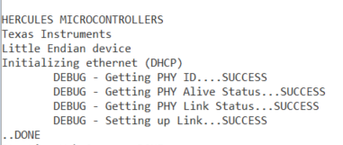

However, the two, FreeRTOS + lwIP seem to not work together. I have managed to successfully setup the EMAC hardware, because I can see these configuration messages in the terminal :
