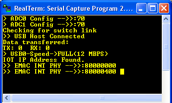

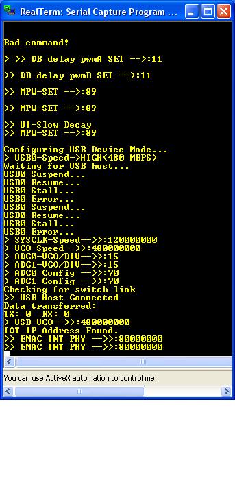

  • Appears the internal PHY resets 480MPS as reported by the USB library call to check the configured device/host speeds prior to initialization completion. After that it ends up in Full Speed mode.
       /* Get the configured PHY transfer speed  */
        //ui32USB0DevSpeed = USBHostSpeedGet();
        ui32USB0DevSpeed = USBDevSpeedGet(USB0_BASE);
        /* Report the speed of USB0 PHY endpoints */
        if(ui32USB0DevSpeed == USB_HIGH_SPEED)
            UARTprintf("> USB0-Speed->HIGH(480 MBPS)\n");
        else if(ui32USB0DevSpeed == USB_FULL_SPEED)
            UARTprintf("> USB0-Speed->FULL(12 MBPS)\n");
        else
            UARTprintf("> USB0-Speed->LOW(1.5 MBPS)\n");
  • Oddly USB0 defaults High Speed (above post), after configuration descriptor is sent EP1 it down shifts to Full Speed. The device descriptor note (below) states USB 1.1 infers USB2.0 and PHY should be faster than 12MBPS.  Hence my confusion that USB0 speed is not being set by a call to configure EP1 speed and the descriptor fails to set HS. It is widely believed USB0 peripheral PHY on the EVM was designed for todays USB2.0 standards and not specifically USB 1.1 post 1998.  My host USB2.0 computer connects to target device PHY, logically it seems could be made to run High speed instead of Full Speed via the internal PHY.
    Otherwise USBHostEndpointSpeed() allows us to set the speed of the HOST control endpoint 0 and or other configured endpoints besides 0.
    TM4C1294 USB 2.0 protocol is not what the computer industry projects to the public being much faster than USB 1.1. Descriptor BCD seems to determine the device connection speed and 0x200 made no difference over that of 0x110. So we now want to try LS configuration, should be simple as changing BCD 0x100 in the device descriptor field.

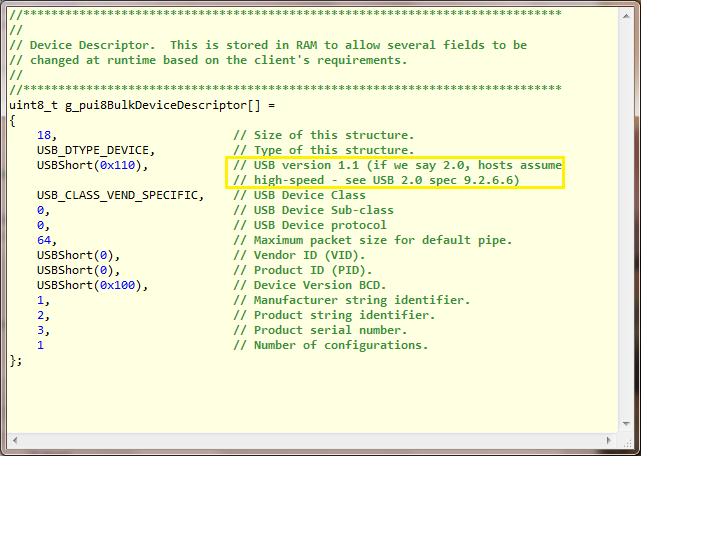

    The bcdUSB field reports the highest version of USB the device supports. The value is in binary coded decimal with a format of 0xJJMN where JJ is the major version number, M is the minor version number and N is the sub minor version number. e.g. USB 2.0 is reported as 0x0200, USB 1.1 as 0x0110 and USB 1.0 as 0x0100.

    As you've identified, yes to follow USB standards we use 64 byte packets for FS mode. You can improve the throughput the way you describe but as it is no longer following USB standard you would have to do that in a close loop system that never actually interacts with a USB standard host.
    A USB2.0 compliant computer PHY would request device information on connection and the TM4C would reply back that it is a full speed device and thus the computer will limit speeds and use 64 byte packets unless the TM4C is configured for HS mode with an external PHY to drive the high speed communication.
    As far as the whole topic of USB2.0 with TM4C, our datasheet lists repeatedly that high speed operation or 2.0 operation requires an external PHY.
    "USB 2.0 Controller OTG/Host/Device with optional high speed using external PHY through ULPI interface"
    "USB 2.0 high-speed (480 Mbps) operation with the integrated ULPI interface communicating with an external PHY"
    On block diagram: "USB OTG (FS PHY or ULPI)"
    While we may agree to disagree on this subjective topic of clarity of statements, I would say we did our job to properly label the capabilities of the device and outlining what is and isn't met from a 2.0 high speed specification standpoint.

  • Hello BP101,
    You should read the USB 2.0 specification again.
    "The USB defines the allowable maximum bulk data payload sizes to be only 8, 16, 32, or 64 bytes for full-speed endpoints and 512 bytes for high-speed endpoints."
    The same is said for other endpoint types, except for Isochronous which is 1,023 bytes.
