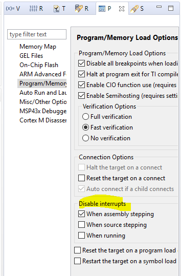

Hello. I have a custom board with TM4C123GH6PM MCU. I use segger for debuging. Then i start debug my code no one interrupts doesn't happend(periodic timer). But if i repower contorller it work correctly. I checked it by toggling led in different interrupt handelrs. I am sure about added IntMasterEnable(); line in my code after initialization. Before using my custom board i used ek-tm4c1294xl for practice and similar code work great(i just changed pinmux). How to fix it?
