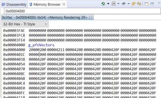

Why is GNU filling the flash until the 0x00004000 address with 0x00? I know the default fillingoption for sections starting with '.' of the gnu linker is 0x00, but why is there code previous of the 0x00004000 address?
This basic question appeared since the TI compiler is leaving this space as it is and therefore isn't overwriting for e.g a bootloader.

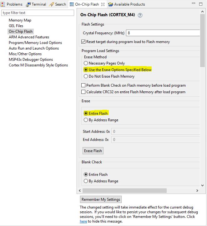

    If you were to use the JTAG to program your firmware image (starting at 0x4000) you will need to make sure that the bootloader is not overwritten. I don't know which IDE/tool you use to program the application image. If you use CCS then please make sure you don't select the "Entire Flash". The default is selecting the radio button "Use the Erase Options Specified Below" and the option that will be selected is "Entire Flash". With the default setting, the CCS will program your application at 0x4000. However, everything from 0x0 to 0x4000 will also be erased. I'm not sure if this is the issue you are asking. If not please clarify your question for me. If you are using  the GNU tool chain to program the flash then the tool should have options that is similar to CCS, I hope , to allow you not erase a certain range of the memory. I have no experience with GNU tool chain. You will need to ask the GNU for support if this is the issue you are asking to resolve.

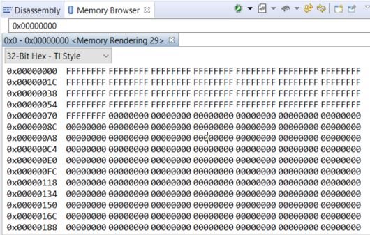

    When i use the TI-compiler for the same project, the flash-memory from 0x00000000 to 0x00004000 stays the same as when i start debugging. With the gcc-compiler this area gets overwritten (with 0x00).

    If you use CCS then can you try what I suggested? You can try two options. One is to select the radio button "Necessary Pages Only". The other option is to select "Use erase options specified below" and provide your memory range which will start at 0x4000.
  • Unfortunately i dont have this options (not sure because of segger or gnu).

    GNU compiler: zeropads the unmentioned memory as shown below.
    So my question is: Why and how is the TI compiler doing that in the right way?
