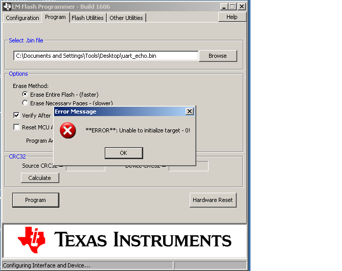

I tried downloading the uart_echo.bin example provided to the board using LM Flash programmer build 1606.
I am always getting "**ERROR**: Unable to initialize target -0!"
In the Configuration TAB I have Quick set "TM4C1294XL LaunchPad".
i also to Unlock the debug port and i get
and the problem still exist
What seems to be the problem here?

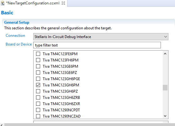

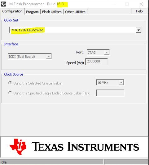

     Can you show your configuration tab?
     Did you select TM4C123G LaunchPad? Please see below. Please also note that the latest version is 1613. You can update the the ICDI firmware in the "Other Utilities".
  • -> yes the version is 1613
    -> i was using stellaris development board

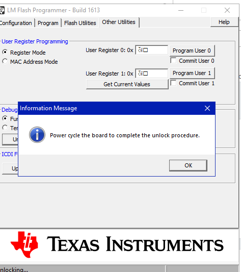

    -> i tried TM4C123G launchPad configuration -> when i try to update the ICDI firmware i get "error:failed to program ICDI device"
    -> when i try to unlock it ,it unlocks successfully

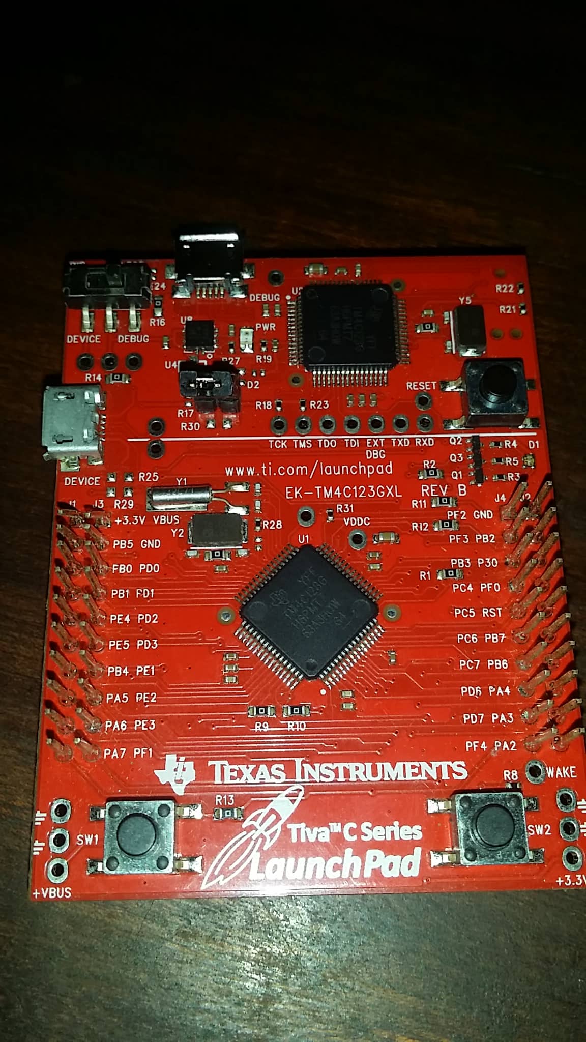

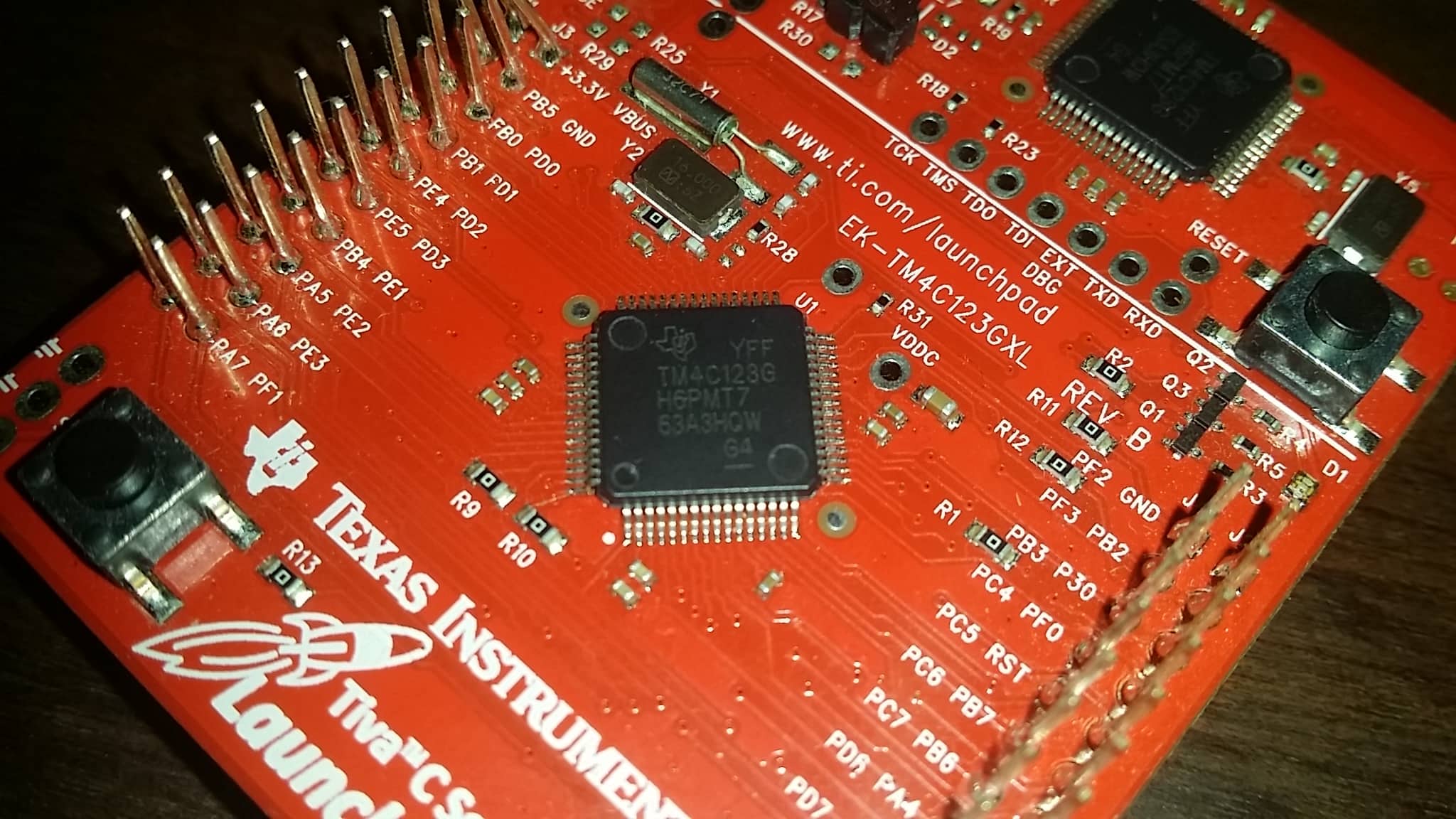

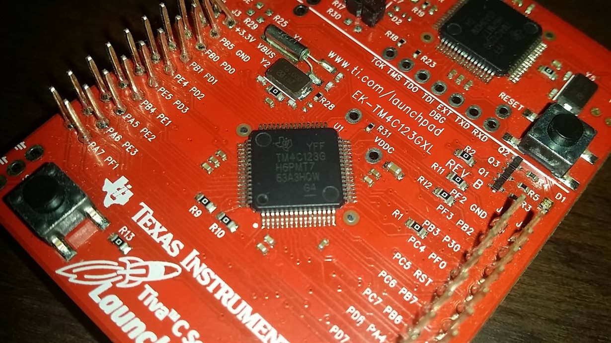

    Can you confirm one more time you are using Stellaris development board or the Tiva TM4C123G development board? Where did you get the Stellaris development board? The Stellaris MCU is NRND (not recommended for New design). We do not support Stellaris any longer. Perhaps you can take a picture of the board as well as the MCU on the board first so I can take a look.
  • Hi Charles,
    i am sorry for wasting your time with me ,i am using Tiva C Tm4c123GH6PM LaunchPad , i choose Stellaris development board before because i was using CCS with This configuration
    so i Thought Stellaris development board was the right choice,
    here are the pictures of the Board
    and here is picture of the MCU on it
    any way i tried Stellaris development board, TM4C123G development board, TM4C123G LaunchPad and non of them works
    i get "Unlock Complete " and when i try to flash a code i get the same thing

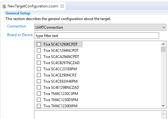

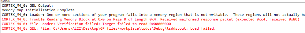

    One more thing that might help, when i try to flash a code using UARTConnection like this
    i get this output
  • Hi Ali,
      Your first image is correct where you choose Stellaris ICDI In-Circuit Debug interface when setting up the target configuration in the CCS. It looks like in the CCS you are connecting to the device successfully, The problem you have is during the flashing the memory. Is this a correct understanding? Do a right click on the target configuration file you just created and select "Launch the target configuration". After you launch the target configuration, you can go to the Run->Connect target. I just wanted to make you are connecting to the target without a problem. If you can successfully connect to the target then you can do Run->Load program and select any one of the TivaWare examples. Instead of selecting the .bin file, can you try selecting the .out file? Do you see any difference?

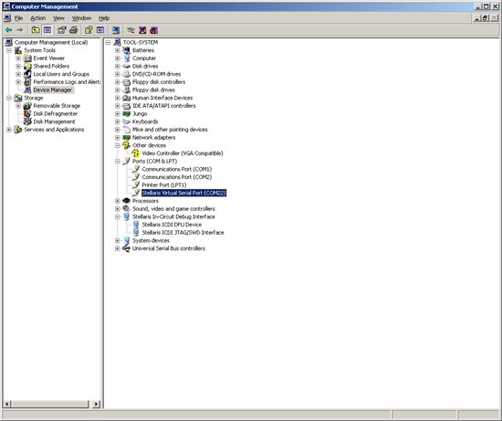

    "It looks like in the CCS you are connecting to the device successfully, The problem you have is during the flashing the memory. Is this a correct understanding? "->  i really don't know what is the problem, if you mean that when i connect the tiva c it appears in the device manager but i can't flash any code then yes ,that is true the kit connects properly and here is a picture of the device manager when i connect it

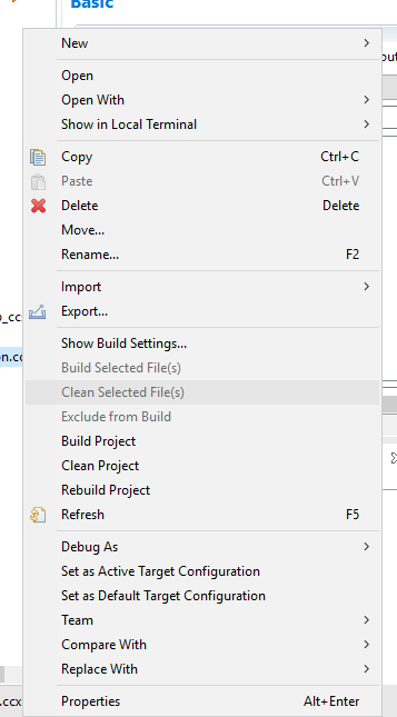

    "Do a right click on the target configuration file you just created and select "Launch the target configuration"-> i can't find Launch target configuration , i connected a working kit to check for it but still can't find it here is a picture of what i get
    i appreciate your time and consideration ,thank you

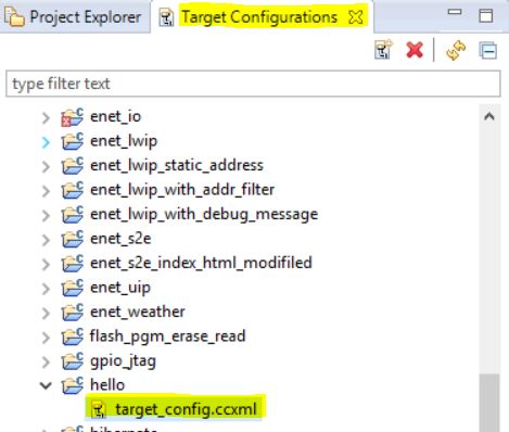

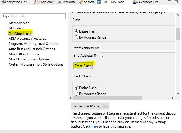

  • Please follow the below steps.
    1. Open the Target Configurations. If you don't see this you can go to View->Target Configurations to open it
    2. I'm using the hello example. You can use any existing TivaWare example and you should find a file called target_config.ccxml
      3. Right click on the target_config.ccxml
      4. Select "Launch Selected Configuration"
      5. Go to Run->Connect Target
      6. Go to Tools->On Chip Flash
      7. You should see below image
     8. Click on the "Erase Flash" button.
    Do you see the flash erased?
     9. Program any of of the TivaWare example. What do you see?

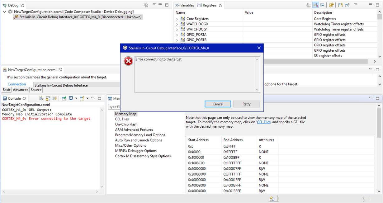

  • hi Charles,

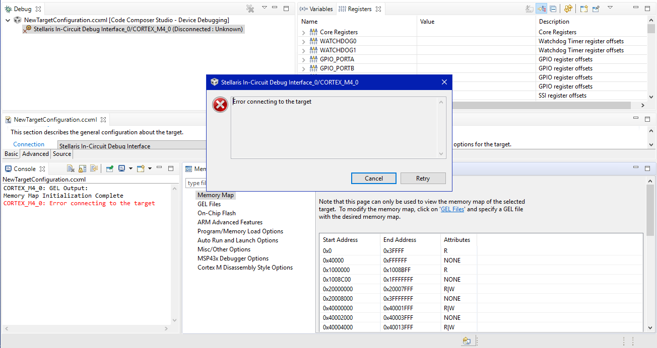

    i did the steps but unfortunately the kit doesn't connect i get this when i do step number 5 "connect target"
      but as i told you before the kit exists at device manager so i think this kit may survive , i have another one that doesn't show at device manager
    and any way if this kit doesn't work , could you please tell what to avoid , what are the causes to this problem so i don't kill another one i have killed 3 already
    thanks again for your time
      You screenshot shows that you are unable to connect.
    Can you tell me if you had loaded any program into the flash before the problem started to occur?
    Did you ever load any TivaWare programs before that was working?
    Did you repurpose any JTAG pins as GPIO pins in your program.
    Did your program put the device in any sleep mode by killing the clocks?
    I have to ask these questions since you said you have killed three launchpad already. Normally, the target is unable to connect because the JTAG pins are repurposed as GPIO pins. These are the PC[3:0] pins.
