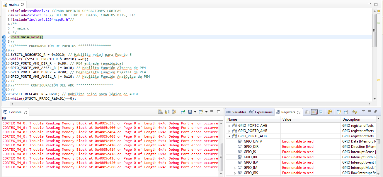

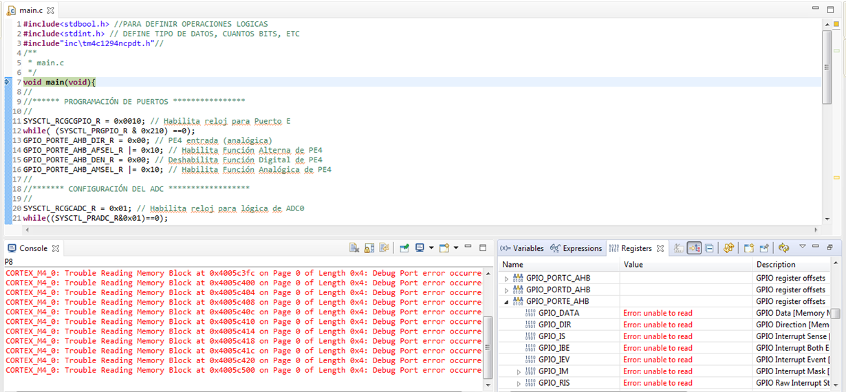

So a couple of days ago I was testing a circuit with my tiva
But now, every time I upload a program to my micro, I can't read any port information, I've tried using the UNIFLASH software and the LMPROGRAMMER.
When I use the UNIFLASH software, I follow all the instructions, before powering up, I hold the reset button, select the appropiate option, and click on unlock....
It seems to start, but then it pops up a message "Module closed", so I guess it doesn't finish debugging the ports
On the other hand, when I use LMPROGRAMMER, I repeat the same process, hold the reset button before powering up, click the appropiate option, click on unlock, and to finish it says to complete a power cycle, not sure what that means.
I'm kinda frustrated, I don't know what else to do.
Please HELP!!
Thank you, community

  • I'm not sure what kind of changes I did. I was testing a circuit. I don't think I'd burnt the board. If that was the case, would it even power up?
    Where exactly can I find the guide for this program?

  • Hi again Charles.
    Is it strictly neccessary to declare the ports to read them?
    I did the all the steps you told me to read in the guide, and uploaded this code:

    I tried to read the data in the specified ports and it shows me the appropiate information for the ports I declared. The other ports seem to be blocked. Is that normal?
