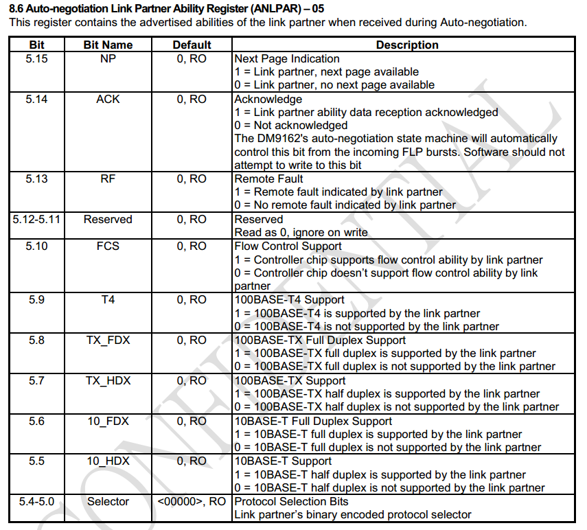

Hi all:
I’m working on the tms570ls3137 with an extend PHY DM9162. I was stuck in the EthPHYLinkStatusGet() process. When I look in I found it was the link status are different between PHY register and MDIO register. In PHY register the link status is valid, but the MDIO register is invalid. The link status has not been updated to MDIO register.
It seems like MDIO has the right configuration, registers can be read and write correctly! Why I got this issue? Anyone help me?
In addition the PHY address is 0x1F and the auto-negotiation has complete like the register shows.
This is the value of the PHY registers.
Basic Mode Control Register, addr: 0 v: 3100
Basic Mode Status Register, addr: 1 v: 786d
Auto-negotiation Advertisement Register, addr: 4 v: 01e1
Auto-negotiation Link Partner Ability Register, addr: 5 v: 45e1
Here is the EthPHYLinkStatusGet code where I stuck.
Auto-negotiation Link Partner Ability Register, addr: 5 has a same define with Auto-negotiation Advertisement Register, addr: 4
