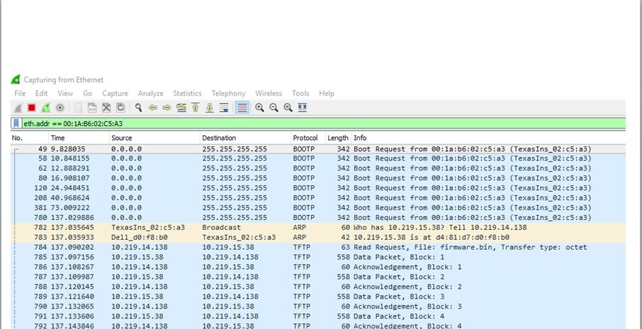

    When the LM flash programmer shows that it is attempting to connect, how long did you wait? Please note that the board will first send a bootp request and if there is no BOOTP server response it will then wait for 2 seconds before it sends another bootp request. If there is still no bootp response from the server then it will wait 4 seconds. In another words, it will wait for a duration of 1s, 2s, 4s, 8s, 16s, 32s and up to 64s before sending its next bootp request if no response from the server. Let's say your application calls the ROM_UpdateEMAC() and you didn't hit the Program button on the LM flash programmer after 16 seconds have elapsed then the board will wait another 32s before sending its next bootp request. During this 32s of time, the LM flash programmer will show that it is attempting to connect. If you don't wait long enough you may not see the handshake happen. The worst case will be to wait for 64s. This is the reason I asked how long did you wait. If you wait a couple of minutes and there is nothing going on then the first thing to check if the board is sending the bootp request out. To find out, you will really need to use the Wireshark to observe the ethernet traffic. You should see something like below.
    The reason I asked that you try the emac_boot_flash example is that it is a proven example. The This is a flash based EMAC bootloader. If you call ROM_UpdateEMAC() then it is invoking the Ethernet bootloader stored in the ROM.  The boot_demo_emac_flash also contains code that will detect the magic packet from the Bootp server. This means that anytime you push the Program button on the LM flash programmer a new update to the firmware can be done remotely. I don't know how you are writing your application. But you should at least take a look at how the boot_demo_emac_flash is done so that it can transfer control to the bootloader.

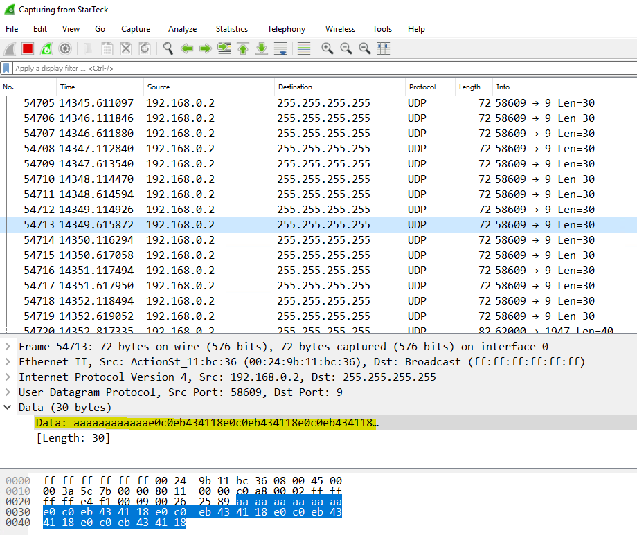

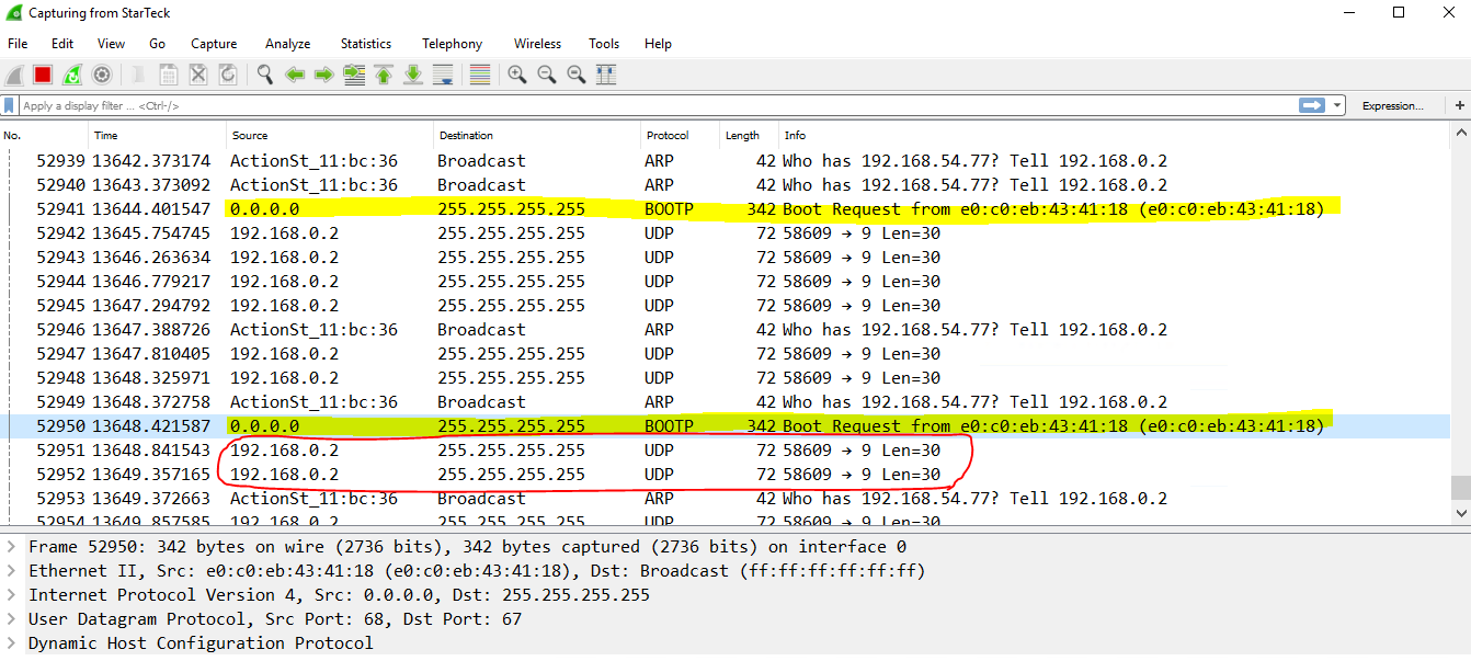

  • Hello Charles,
    I just changed my code and i included the NVIC_DIS4 register as well, and now it looks like the controller is sending BOOTP packet as I captured on wireshark.
    Please note my controller IP address is 192.168.0.1 NOT 0.0.0.0 and my LM Flash Programmer is on 192.168.0.2.
    Also you can see the LM FlashProgrammer is also sending a broadcast message as higlighet in red circle in above picture.
    In the following image it shows the LM Flash Programmer is also sending a magick packet ??
    However the LM Flash controller status is "Attempting to connect..." . I left it in that status for 3-4 minutes to see if it connects but it looks as if it is stuck there.

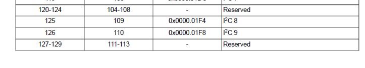

    I have one question. Accroding to Datasheet there isnt any register NVIC_DIS4 ( 0xE000E190 ) on the chip while in actual if I comment writing to that register in my code, the controller will hang.
    Here is the working code;
                HWREG(NVIC_DIS0) = 0xFFFFFFFF;
                HWREG(NVIC_DIS1) = 0xFFFFFFFF;
                HWREG(NVIC_DIS2) = 0xFFFFFFFF;
                HWREG(NVIC_DIS3) = 0xFFFFFFFF;
                HWREG(NVIC_DIS4) = 0xFFFFFFFF;
                ROM_SysTickIntDisable();
                ROM_SysTickDisable();
                ROM_UpdateEMAC(sys_clock);
  • Hi Sahil,
      Glad that your problem is solved. I think you need the NVIC_DIS4 as well.  The implemented interrupt table is more than 96 channels for which the NVIC_DIS4 is used to disable channels beyond 96.
