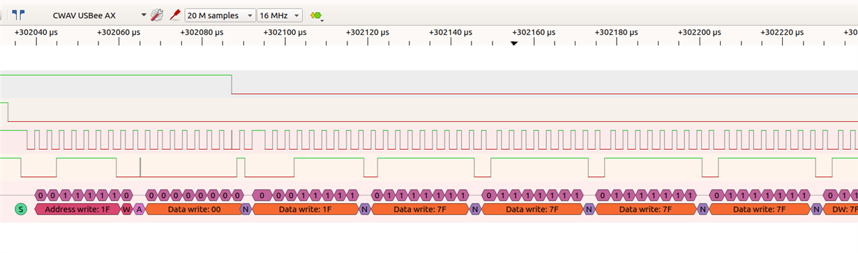

  • Hello Charles,
    I have changed the intterrupt handlers to:
    // gyro interrupt service routine
    void gyro_isr(void) {
        MAP_GPIOPinWrite(GPIO_PORTA_BASE, GPIO_PIN_2, GPIO_PIN_2);
        if(GPIOIntStatus(GPIO_PORTD_BASE, true) & GPIO_PIN_3) {
            GPIOIntClear(GPIO_PORTD_BASE, GPIO_PIN_3);
            gyro_data_ready = true;
        GPIOIntStatus(GPIO_PORTD_BASE, false);
        MAP_GPIOPinWrite(GPIO_PORTA_BASE, GPIO_PIN_2, 0x00);
    // accelmag interrupt service routine
    void accelmag_isr(void) {
        MAP_GPIOPinWrite(GPIO_PORTA_BASE, GPIO_PIN_3, GPIO_PIN_3);
        if(GPIOIntStatus(GPIO_PORTB_BASE, true) & GPIO_PIN_5) {
            GPIOIntClear(GPIO_PORTB_BASE, GPIO_PIN_5);
            accelmag_data_ready = true;
        GPIOIntStatus(GPIO_PORTB_BASE, false);
        MAP_GPIOPinWrite(GPIO_PORTA_BASE, GPIO_PIN_3, 0x00);
    So everytime the ISR is entered I get a small spike in the scope.
    I also hooked up a logic analyzer and captured both interrupt lines, both PA2,PA3 for the seeing the spikes, as well as I2C0[SCL,SDA] and I2C3[SCL,SDA]
    (I am using i2c0 for one sensor and i2c3 for the other)
    The top 4 (D0 to D3) is the gyro sensor, D0: interrupt D1: PA2, D2: SCL3, D3: SDA3
    The bottom 4 (D4 to D7) is the accelmag sensor, D4: interrupt, D5: PA3, D6: SCL3, D7: SDA3
    This is just where the accelmag sensor stops responding, near to the end, the interrupt line falls at D4, you see the spike at D5, and I2C data transfer takes place, but the interrupt line is never de-asserted again.
    I am using two seperate boards [adafruit.com/product/3463], from one i just use the gyro, from the other accelmag only. [I did this so I could hook them on different i2c buses] - but they also have different voltage regulators, both being fed from the 5V on the tm4c123 launchpad.

  • Greetings,
    Your effort is well-thought, properly detailed & impressive.     Good job!      As so often stated here (by vendor & 'others') the use of an instrument which can 'see & capture' Serial-Bus Activity - proves (almost) mandatory.     And is ALWAYS helpful.
    I believe that you've well followed vendor's Charles guidance - and the screen cap is extremely helpful.    That said - a question arises - it being, "Why is there an (apparent) 'Delay' - imposed upon the gyro-sensor's 'SCL & SDA's' signal output (top traces) (post its interrupt toggle ('H' -> 'L'))?    Note that 'No such delay' (or a far smaller one) arrives w/the accel sensor!
    Might that (apparent) delay - imposed upon the gyro sensor's I2C transactions - result from the 'switch-over' from one I2C channel to the second?    It is believed the actual code is required for such analysis.    (and thinking (out loud) further - there may exist, 'No such switch-over' - each 'unique' I2C transaction will occur upon its (own) I2C bus - which has (already) been set-up & configured.)
    Thinking further - 'Part deux' - might the accel sensor demand an 'extension' (i.e. be 'multi-byte') which would explain its increased duration?    (when compared to the 'briefer' gyro sensor.)
    Follows several observations/comments - for your consideration:
    • Might that result from the (assumed) Logic Analyzer's 'Trigger' (if one) - being 'keyed to D4' (the accel sensor's) interrupt line?
    • Accel sensor's I2C transactions appear to 'persist longer' than those of the gyro sensor.    Is that expected?
    • The 'width' of the accel sensor's interrupt signal (when active) appears smaller than that of the gyro sensor
    •  No/Zero 'difference' in signaling is evident leading up to - or during - the fateful/final accel-sensor transaction.    (where it 'hangs')
    Here's a visual (super-imposed upon your original) - highlighting the (apparent) 'hold-off' of the gyro-sensor's I2C signals.    Such 'hold-off' is either, 'Non-existent' or too minimal to note - upon the accel-sensor!   (and again - this may be a 'trigger' issue ... yet such 'Should be noted!')

  • Hi cb1,
      Thank you! You have asked all the good questions that I want to ask too.
    Hi Can,
      From what I can see, the MCU seems to behave as expected. It is the last I2C transaction you need to investigate. What command was sent to the Acc sensor? Is it a valid/correct command?
      In the various prior posts you said that the Acc generates an interrupt on the rise edge. Why both the Gyro and Acc generate interrupt on the falling edge as appeared on your LA capture.

    Here is what I think is happening on the scopecap:
    1. whichever interrupt comes first, triggers an i2c read. here in D4 going low the first time, it triggers an i2c read. notice that since this is the accelmag sensor, and it has 13 bytes to read it takes longer than the interrupt clears. according to datasheet reading the mag registers cause interrupt to deassert, so it does deassert while the i2c transaction is continuing.
    2. while this happening the gyro interrupt comes in at D0. however the i2c transaction will have to wait, as main loop has not finished reading the accelmag.
    3.only after the first i2c read is finished, the gyro read begins. as seen on D2 and D3. As soon as read is finished gyro int is deasserted.
    4. "Accel sensor's I2C transactions appear to 'persist longer' than those of the gyro sensor.    Is that expected?" <- yes, because it is 13bytes.
    Since yesterday I am using only one i2c channel. The problem still persists.
    If operated seperately the gyro has 402.322hz output. (if specified to be 400) the accelmag has 398.812hz output data rate. (if specified to be 400)
    Since gyro outpus at 402 and accelmag at 398, one signal will sweep other, and it will cause a 'hold-off' in an alternating fashion. it is either the gyro keeping the i2c busy, and accelmag has to hold-off, and or the otherway around (accelmag keeping i2c busy, and gyro read has to be hold-off.
    This irregularity in reading could be the cause of the crash.

  • HI Can,
      Your analysis is not correct. You are doing your Accel I2C read in the main loop, isn't? When an interrupt from gyro comes in, it will interrupt the Accel read right away. The CPU is not going to wait for the 13 bytes in the Accel to complete before it jumps to the gyro ISR. You could potentially have two flags, the gyro_data_ready and accelmag_data_read true at the same time. After the CPU comes out of the gyro interrupt, it depends on how you write your main loop to continue the remaining data read of the Accelmag or the gyro. Very likely your Accelmag read is interrupted in the middle. For example, the Accelmag read is interrupted in the middle of a 7th read before you are interrupted by the gyro. The Accelmag read on the 7th byte is likely to be corrupted. Did you check the I2C transaction as I suggested. Did the sensor even ack'ed the I2C transaction?
  • There is one workaround that I can think of and worth for you to try. That is, before you start to read the data from a sensor, you disable the processor interrupt globally. You only enable the interrupt after you complete the read. For example, before you read the 13 bytes accel sensor data, you will first disable the interrupt in the accelmag ISR and only enable the processor interrupt after the 13 bytes are completely read. Do the same for the gyro too.
    I think your problem is a classical race condition. You may need to slow down your data rate from 400Hz to some slower speed. Try 200Hz data rate if this is programmable in your sensor and I think it will help your problem.

    I did capture and decode i2c bus during failure. It took me a while to get pulseview going on ubuntu with all the decoding facilities.
    Here is zoom of a successful transaction:
    1F is the address of the accelmag sensor. In a successful transaction, address write is followed by a data write (0x00 being status) register, then an adress read, then 13 data reads.
    Here is a zoom of a failed transaction
    address write to 1f, followed by data write, as in the successful transaction but after that It continues with data write, instead of data read.
    Also the first data write in the successful transaction is followed by an ack and start repeat, but in the failing transaction, it is followed by a NACK.
    I also captured the fail few times, and and observed that: it is not always following the data write, it could fail looking just like the successful transaction, except the read data is FF all the time. Here is one example of it:
    A common patterns between different fails are as PE2 goes low, (the accelmag interrupt) the i2c clock makes a spike. (I put a black dot to where it is)
    Now I am suspecting:
    a. it is the wiring
    b.i am using i2c2 at PE4, and PE5. interrupt pin is also PE2. maybe i2c2 is getting confused, as this isr triggers?
    c. the sensor maybe causing this spike, and corrupting the structure.

  • Staff (especially) and I, 'Applaud' (loudly) this terrific 'SENSOR' analysis.    Staff is searching for 'Pulseview' - to be operated under WIN7 and/or WIN10.
    You may note that we (earlier) noted the 'neatness' of your 'preformed' wire connectors - yet judged them as 'too long' - inviting the potential for illegal signal introduction(s)!
    Your current 'Screen-Cap' proves 'outstanding' - we 'wish' such could have arrived (20-30) posts sooner.     (you may consider such 'wish' - for your 'gathering of facts' for 'Future Issues.')
    Here is a zoom of a failed transaction address write to 1f, followed by data write, as in the successful transaction but after that It continues with data write, instead of data read.
    We very much like your description detail (above) yet should it not have mentioned the 'missed' ACK' - which occurred, 'Immediately after that first Data Write (0x00)' - during the (first) failed-byte I2C transaction.    Note that vendor's Charles had 'urged' your 'search' for such 'failed ACK.'     The issue - at least in this specific case - appears to be the 'glitch' impressed upon your 'SCL' pulse train - during the very first 'Data Write' - which is almost certain to have caused (at least contributed to) the missed ACK!
    Earlier I advised you - along w/'shortening your wire interconnects' to 'Relocate the SCL wire as 'FAR as possible' from the wire bunch!'     It would even prove worthwhile to employ a 'shielded cable' to reduce the possibility of (unwanted) signal coupling.   (ground just one side of that shielded cable)
    Now you made the observation,  "c. the sensor may be causing this spike, and corrupting the structure."
    There are (predictable) causes of such glitch/spikes - follows several:
    • inadequate voltage or current at (either) the MCU or Sensor board.    (such must be 'measured' during operation (program running) Not at 'idle.')
    • inadequate 'common ground' joining: Power, MCU board, Sensor board
    • mismatch of voltage level between MCU & sensor board.   (we recall your mention of 'voltage translators' upon the sensor board - these warrant 'measured examination.')
    • it is 'w/in the realm' that your 'Set-Up/Config' of the I2C module proves - in some way - sub-optimal.   (i.e. it (usually) works - but may be 'vulnerable' to 'disturbance!')
    What to do - now?
    • the glitch upon 'SCL' may be 'MCU or Sensor' originated
    • insertion of a resistor (say 2K2 or so) between 'Sensor Interrupt & MCU's SCL pin' will (likely) enable the detection of (which) end - caused the spike.   (the 'earliest & largest' spike observance - indicates the 'most likely' - offending source.
    • we are 'bothered' as to 'How & Why - even If' - that very first (illegal) 'Data Write' (0x1F) - which should have been an 'Address Read') was 'MCU or Sensor' CAUSED!
    We have 'methods/ideas' - but leave that last analysis (which end first corrupted the 'intended Address Read' to you.     (as we are informed/advised that  "You 'cannot stop yourself.")      Note that a 'reasonable hint' as to identifying that 'Corruption source' has been provided... (Address Read 'forced instead' into 'Data Write')
    You  may applaud our 'newly arrived' (college student staff) - should you determine this (mostly their) analysis well thought, presented and of value...    (simply 'click' the ** LIKE ** button...)
