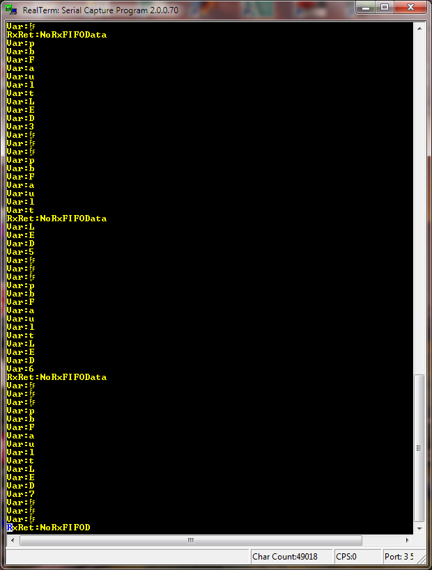

EK-TM4C1294XL: UART get read data ignores array size
Guru 56418 points
Part Number: EK-TM4C1294XL
Seemingly our multidimensional C++ array ends up being a serial C array x 2  rather than (I x d) as in char[257][9]. Below FIFO behavior (Early return from 7/8 full interrupt) even though there should be 128, 256, 1024 byte levels to store external RX data prior to a return from RX interrupt call processing.  Capture below indicates the multi dimensional array of 256 BYTES is not being filled and UARTCharAvail() thinks there is no more space in the array. Perhaps incorrectly returns from interrupt handler in the middle of incoming data streams to FIFO 16x8 storage area.
A continuous RX data stream broken up by either FIFO interrupt issues and faster/slower baud rates do not correct mid cycle returns random loss of data from occurring. The interrupt should pend again 7/8 full even after being cleared prior to entry but note the several returns to INT caller below. The while loop UARTCharAvail() obviously thinks no more serial data is being sent into the FIFO when in fact it never stopped. Why would the 7/8 interrupt ever inflict handler re-entrance when the while loop should have never ended to being with?  Also test disable UART2 interrupt inside INT hander and perhaps the Index pointer is still being corrupted claimed to correct (uartstdio.c) via UART_BUFFER? The UART2 appears to Stall no matter how the FIFO interrupt has been configured.

  • Hi Charles,
    I think this issue of RX FIFIO is due to the RXFE flag firing multiple times for the same character in blocking or non-blocking modes via RX INT 7/8 auto cleared or forced makes no difference. I had to move Tivaware HWREG calls code into the RX INT handler or the FIFO would omit serial data being loaded into any single wide char array. The UART example is blocking single character and the same TX char (!) so you would not be aware of issues such as when external device transfers data into the TM4C in asynchronous time and expects an immediate return on TX, UARTPrintf() BUFFERED would mask over this issue, perhaps a race condition thus disables RX interrupt seemingly for the reason RXFE is firing more than it should in non blocking writes.
    As the above capture indicates far more than 16 bytes can be buffered via 7/8 INT with a multi level dim array but 25 characters seems to be the HW limit. So 15 bytes all that can be (error free) buffered in 7/8 full, even with INT disabled in the handler the auto INT clear forces the handler early return no matter amount of free space in the multi dim array buffer.
    It seems UART2 RXFE bit is causing issues with TX interrupt processing, produces incorrect or no output of immediate echo back char being printed on UART0. Partly find it Odd there is only a single UARTDR register for both TX/RX FIFO complicating round robin timing between two interrupt loop handlers. The HW can not handle a round robin character wrap on the data side (UARTDR) I/O from both FIFO's using UARTDR as the port. Even if enable (uartstdio.c) Echo the console characters are not echoed back to terminal, perhaps very same reason reported here. The WA is below:

    Var is the character in the RX array being printed on UART0 via UARTprintf(). The 0x70 is preamble byte, the others (FC) are rogue RXFE toggles, perhaps during blocking.  Other than that I need these variables to do application functions which GUI composer now does via SWD loading symbols via ICDI on JTAG port. Have to get the variable name to be recognized as symbols or load each as a command. Not yet sure how the call back was supposed to do that alone. CAN port commands already exist in this project so that may be the alternative for UART2 to follow up on.

  • UART2 Busy signal did not correct RXFE flagging auto returns from RX_INT but did allow TX_INT after RX of 3 (0xff) break point.
    Still believe we should be able to buffer up to 256 characters prior RXFE 7/8 auto INT returns. The RXFE flag 7/8 full is stated in datasheet as INT Auto Clear, not POP INT handler from the call stack when processing (for, while) loops. That's what seems to occur RXFE 7/8 INT flag forces call stack POP in the middle of buffering array data.
    So a multi dimensional array MDA (char[256][8];) should produce 256 Byte (2048 bits) FIFO buffer.  256 row indexes, 8 columns indirect addressable by two incremented integers, e.g. char[i] for the  index,  char[d] for the 8 columns data. The MDA seems to fill only via the first defined array index and skip the rows.
    That part may be C language related CCS compiler as C++ calls to MDA are being ignored.

  • Charles Tsai said:
    The cmdline.c is a high level utility. It doesn't deal with the UART directly.
    Hi Charles,
    The problem with RXFE call stack pop was being caused by calling the RX data function via the UART interrupt handler. Oddly (cmdline.c) would only point to the first buffered command and mangle the index upon INT handler re-entry after a break at the end of last RX data.
    The fix required calling RX function via another loop handler such as Systick or GPTM in 5ms intervals. It seems the application (CPU) could not process array buffered[] commands from the command struct list after the argument matched command was returned.
