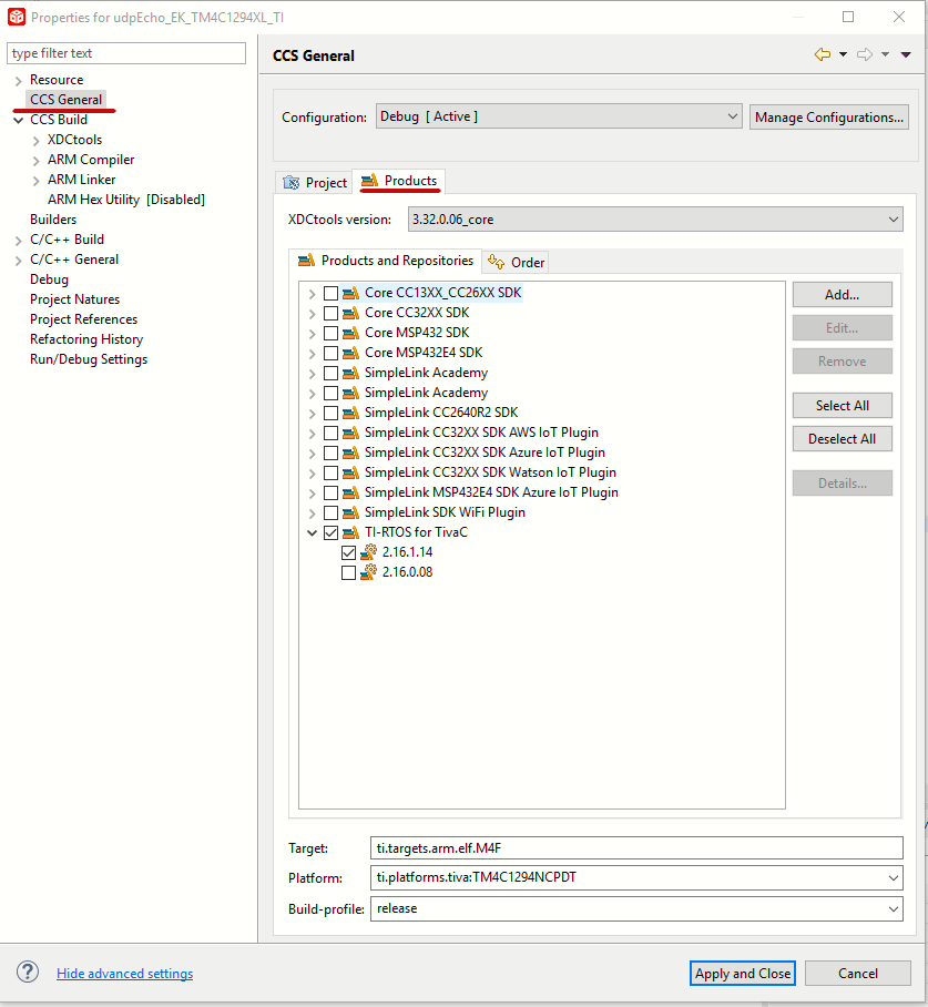

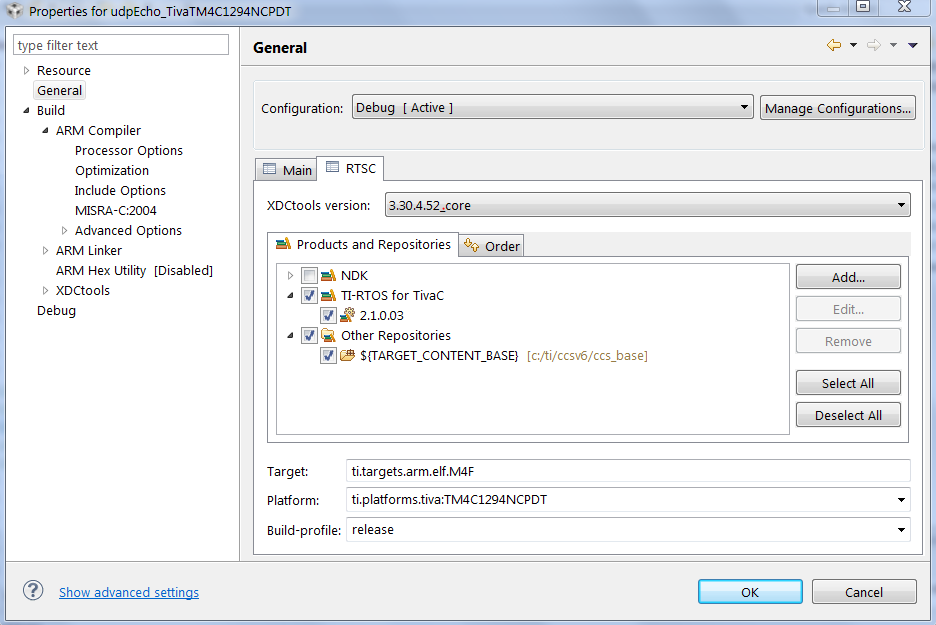

  • Hi Raj,
    Can you right-click on your project in CCS and open Properties, then click the CCS General tab, then Products and show me the products your project is using so that I make sure I look at the correct code:
    Brandon
    Thank you for replying, Here is the screenshot of the same.
  • Hi Raj,
    Thanks for providing that screenshot. I'm not seeing anything immediately wrong with your udp_func and the -1 return code doesn't tell us very much. Are you able to step up and into the function call for sendto() with the debugger? Maybe you could narrow down where the function is running into trouble. It could be at SockConnect(), SockSend(), etc. It would be very helpful to find the origin of the error, if possible.
