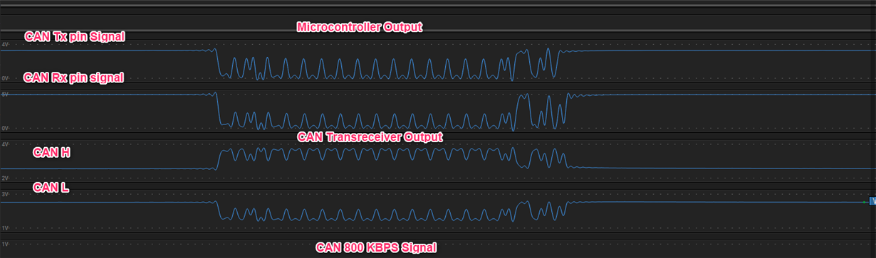

    We have generated the CAN signals for 500Kbps and 800Kbps, its working like a charm. Here is the screenshot for those signals respectively.

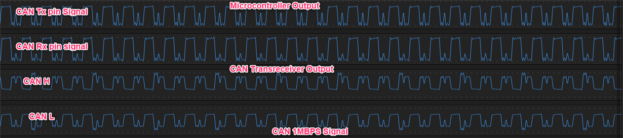

    But when we check the CAN signals for 1Mbps, its sending irregular data. Please find the screenshot below.

    Both your 500 & 800Kbps captures appear to 'nicely frame' (i.e. center) a CAN Bus transaction.    (i.e.  each of the 4  CAN Signals clearly/cleanly reveal the transition from 'Inactive - to Active - back to Inactive'  CAN Bus.)      Such can not be said for the 1Mbps presentation!
    As specifically regards that 1Mbps screenshot:
    • Has the horizontal scale changed?     And if so - by how much?
    • The CAN_TX signal now (appears) to alternate between a (reasonable) square wave followed by a far narrower triangle wave.    This leads to the expectation that the baud-rate has (greatly) declined from the (claimed) 800Kbps.    Kindly measure (again) and advise.
    • In all cases - your MCU's CAN_TX & CAN_RX signals appear 'in phase.'     Is this expected?    (may result from your CAN Xcvr - I don't recall our CAN implementations operating in that manner)
    • The 'normal/customary' CAN Bus Transceiver signals are properly biased at your 500 & 800Kbps rates.    The 1Mbps outputs do not show (either) of those bias levels.
    Scope caps were also requested 'Just past your termination network.'     It is suggested that you 'simplify' that network to 'resistor alone'  (temporarily) - and then test/observe & report.
    Have you confirmed that your CAN Xcvr is (really) capable at 1Mbps?    (and at MCU's 3V3 levels?)

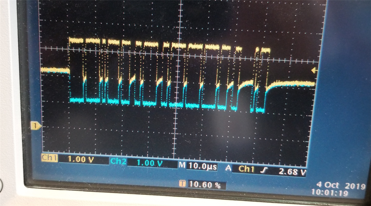

  • I think the sample rate on your oscilloscope is too low. Here is a scope shot of the TM4C123 transmitting at 1Mb using a 300MHz oscilloscope:
    Here is what it looks like with a logic analyzer sampling at 100MHz:
    Once you get a good scope picture, are you getting square waves out of the CAN transceiver? If not, try removing your common mode choke.
