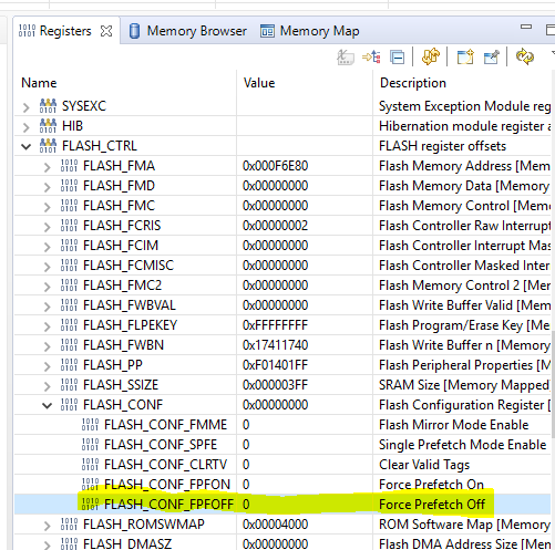

    Starting with the program which fails, if you use the debugger to set the FPFOFF (Force Prefetch Off) bit in the Flash Configuration Register before running the program does that prevent the failure?

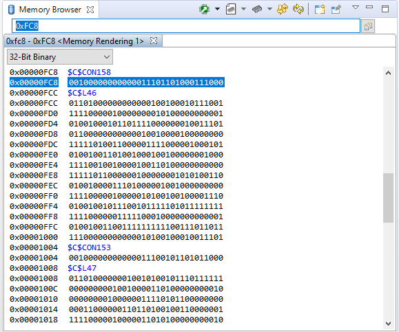

  • can you explain how can i change that bit while using the debugger? i'm a newbie in microcontroller world.
    if it's this register i think it's arleady at 1 the bit 16
  • That is not the correct address. The Flash memory control base address is 0x400FD000, so the actual address is 0x400FDFC8. The easiest way to see it is to use the register window as shown below:
  • finally a good news! that bit is making it working, I have also fixed the keypad removing the delay in the interrupt and also the RTC is fixed with this bit!
    how can i keep it always at 1?
    thank you
  • You can turn off the prefetch buffers with this code:
