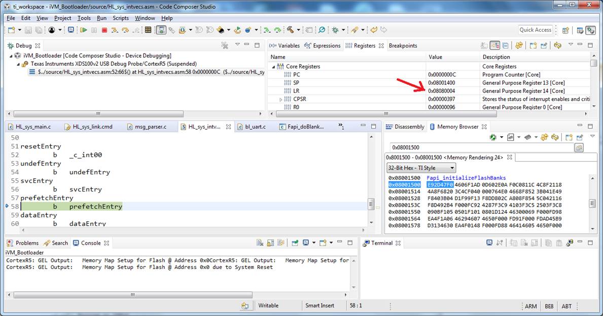

When the code is running as soon as the following line is reached a prefetchEntry interrupt fires;
fapi_status = Fapi_initializeFlashBanks( SYS_CLK_FREQ );
I have included a screenshot from them below. Unless we are understanding the LR register wrong, it seems the fault originates at an address outside of the defined memory region (0x08080004)?
Another thing noticed is the RAM ECC region doesn’t seem to be initialized? This obviously doesn't seem normal.
Suggestions welcomed.

Hello Chris,
You are having a Prefetch abort. What is the CPSR register value?
The F021 Flash API routines must be run in a privileged mode to allow access to the Flash memory controller registers.
best regards,
David Zhou
Hello David,
The CPSR register value was 0x397 (see screenshot).
The Flash functions were working fine until they apparently moved the library to RAM.
Any other words of wisdom you can share would be greatly appreciated!
TY,
Chris

David,
Again, thanks for your help. It appears the cache setting for the SRAM memory region might have been the main culprit.
At this point the customer's F021 routines are successfully executing from SRAM. They can read and erase/write to Flash memory with one caveat;
Now they're encountering an interrupt vector fault when attempting an erase of a sector in Flash Bank 0. Probably some sort of user configuration/setup issue. Again no further actions required on your end from this thread's perspective. I’ll keep you posted if otherwise.
