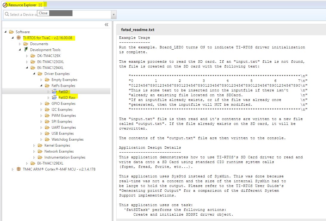

I check and we can use flash memory instead of sd card but removing the jumper connector 13, 14 from J7 on board dk-tm4c129x. But when I did this, I am getting this error-
Starting the FatSD example
Drive 0 is mounted
Creating a new file "fat:0:input.txt"...Error: "fat:0:input.txt" could not be created.
Please check the Getting Started Guide if additional jumpers are necessary.
Aborting...
Any idea what else I need?
I removed the sd card also to make sure it is only using flash. I am using fatsd example as mentioned above.

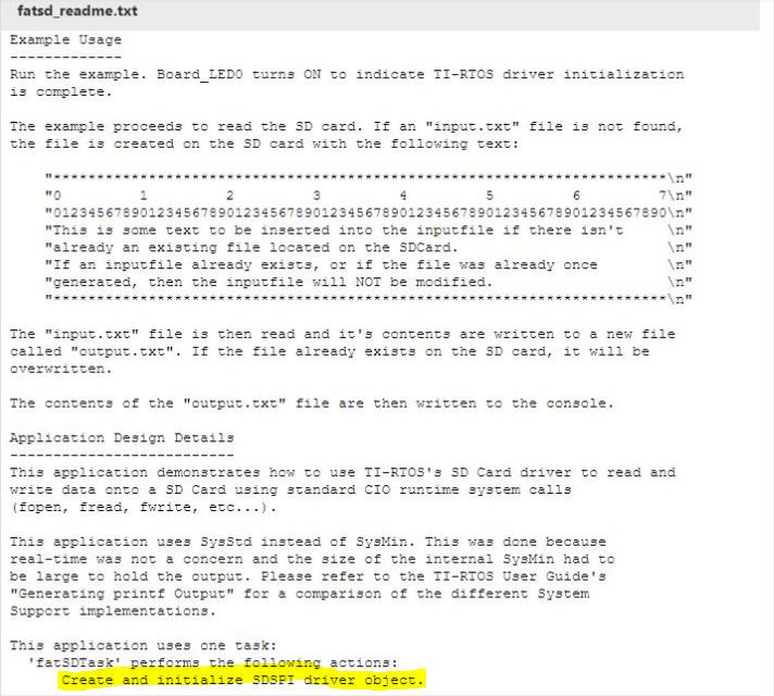

Can you please take a look at this post with replies/example from Todd and see if it helps?
Hi Charles,
AS Todd said there- I would not try to use the SDSPI for the MX66L5.
I want to know why? I have in my system both the sd cards and flash. And I am using sdspi for sd card. Also, in that example, why I am not able to use sdspi for flash.
