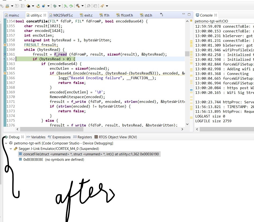

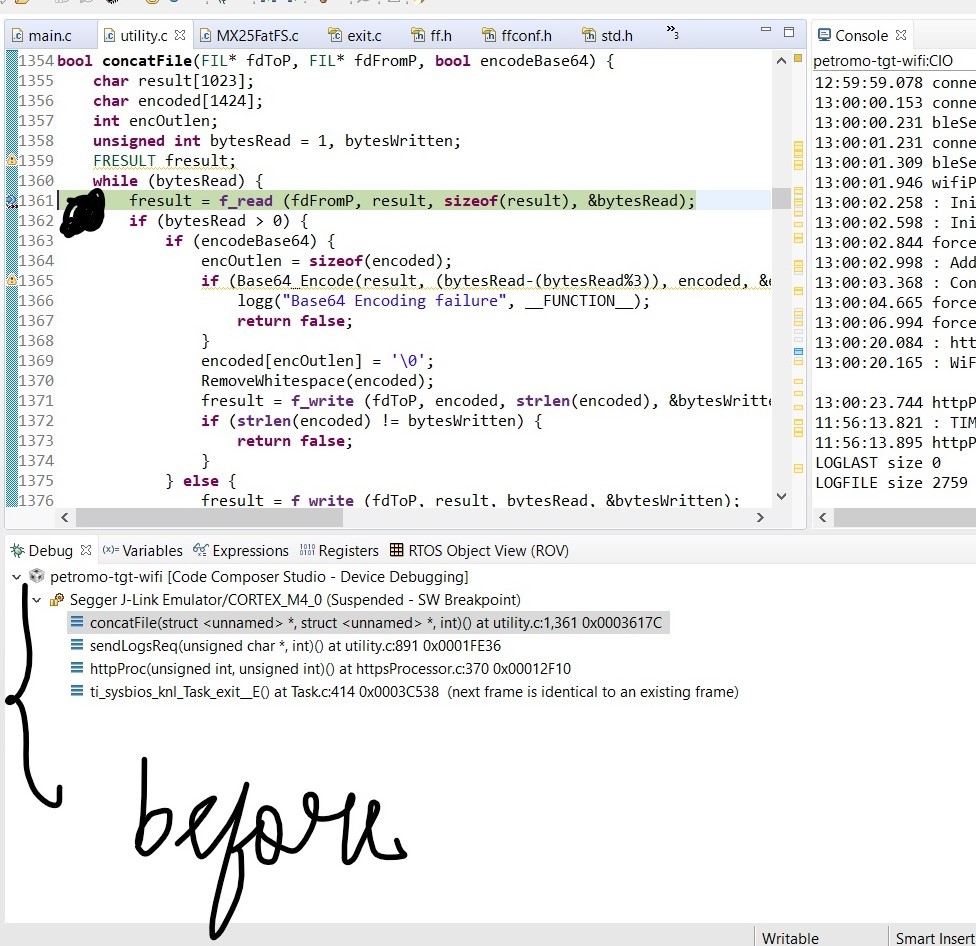

I have created the CONFIG file, LOGSENT file, LOGFILE file in the flash memory. I am able to read/write/open ( fatfs API calls )  the CONFIG file and LOGSENT file. But when it comes to LOGFILE, I can only do open/write operations. When I try to read the log file, it is giving some weird error. I am attaching the 2 screenshots. One before the reading the LOGFILE, and one after reading the LOGFILE. I want you to see the debug window. After the f_read call, my function stack goes corrupt and I got an exception-
LOGFILE size 6807
Error:E_hardFault: FORCED
Error:E_busFault: PRECISERR: Immediate Bus Fault, exact addr known, address: bebebebe
FSR = 0x0000
HFSR = 0x40000000
DFSR = 0x00000000
MMAR = 0xbebebebe
BFAR = 0xbebebebe
AFSR = 0x00000000
Terminating execution...
This only happens when I use the buffer size of 4096. If it is replaced to 512, everything runs fine. I have to use 4096 buffer size. Please let me know. Thanks
  • Hi Akhilesh,
    Can you take a look at Tools->ROV->Tasks->Detailed to see how big your tasks stacks are? Do you happen to have the buffer of size 512 or 4096 as a local variable? If so, when you increase from 512->4096, I expect you need to increase your task stack size also (or make the buffer a global or alloc it).
    Note: I'm suspecting this because we initialize task stacks with 0xbebebebe.
    Todd
  • Hi Todd,
    I resolved this issue. Let me understand if I am doing right.
    What I did is I changed the buffer size in ffconf.h. The FATfs I am using is from ti rtos. So I had to rebuild the ti rtos components in order to make these changes effective. When I rebuilt it, it is working fine. But again I have a few doubts.

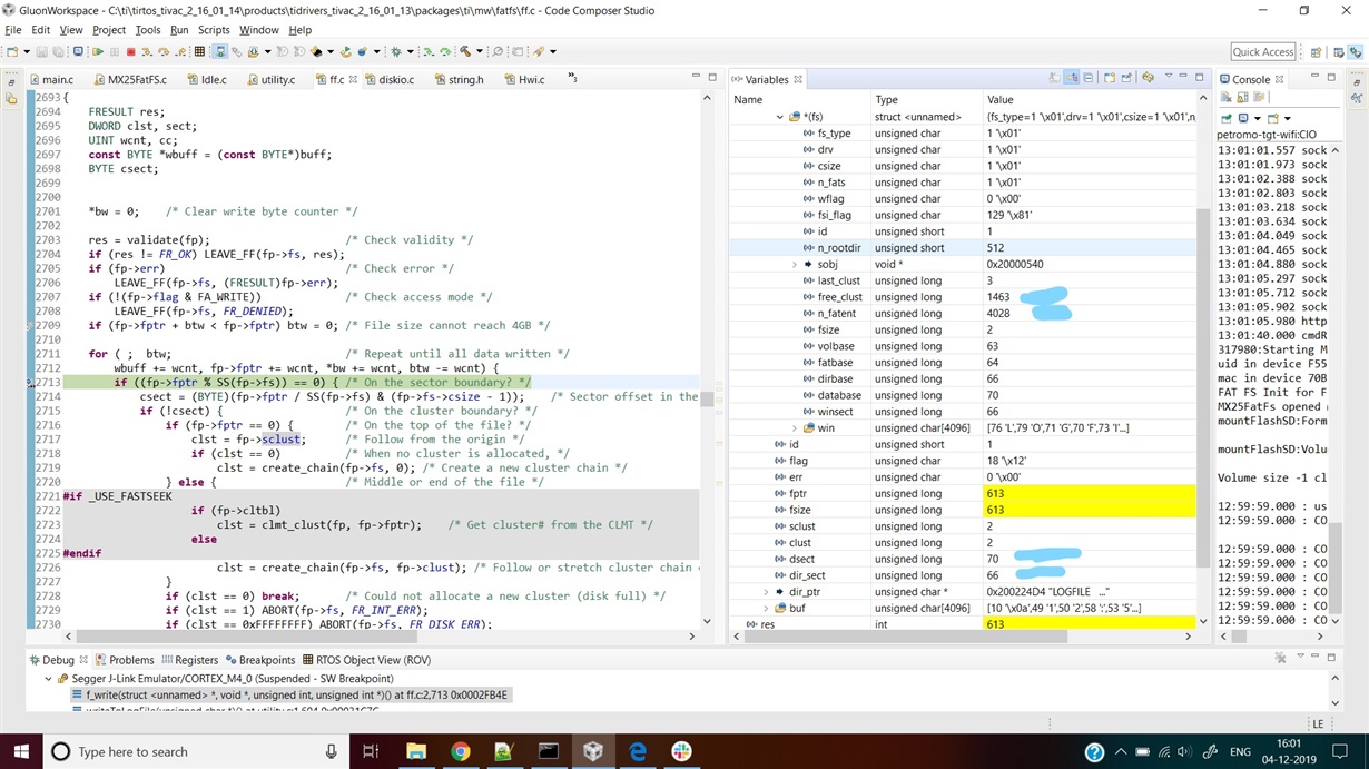

    Just a query, how will you suggest to me to read/write operation using ROM APIs on fatfs at a low level.
    1 more thing. I am attaching the screenshot also.
    When I format the flash and start creating file and writing, I have some doubts about the no of free clusters and others.
    1. Volume size 537040504 clusters after calling  f_getfree(path, &fre_clust, &g_MX25Handle);
    I don't understand why it is showing such a large value.
    2. During the debugging, I checked the value of FIlL ptr and those are in the screenshot attached.
    - free_clust = 1463. Why??
    - n_fatent = 4028. Is this because I have set the buffer size of 4096 and the total no of sectors is 4096? My csize is 1 i.e. 1 sector per cluster.
    - My volume base starts at sector 63. Why? It wastes a lot of space. (62*4KB).
    - fatbase starts at 64.
    - dirbase starts at 66
    -database starts at 70. Why? (Check the attached screenshots )
    What is it doing from 0-63 sectors?
