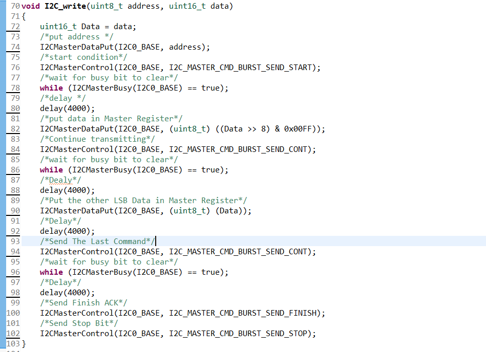

Hello, I'm interfacing with LDC1614 using I2C module in Tiva C Tm4c1294NCPDT, There is something wrong I can't understand in I2C module, when I was polling in Busy bit in I2CMCS Register, the bit doesn't even changed when I was debugging, I resolved it with software delay but it's wrong I guess, I wanna use polling in the right bit in the register cause without this delay the module would be too fast that the sensor can't write or read
short story long: I use Burst mode command as I senf 16-bit data twice (8-bit per command), in line 78 as an example, The Busy bit in I2CMCS doesn't change so there is no polling, I followed the flowchart in the datasheet, but it didn't work
P.S: Here is a piece of code of my LDC_write Function

what is the use of this line, The BUSY bit is 0 and does not change while the I2CMCS register has 0x00000003;
There is a race condition in the I2C hardware. Please use the below code for example. The third line is supposed to wait until the I2C master is not busy before proceeding to the subsequent code. However, with the race condition, the third line will immediately fall through. The purpose to add the second line is to first wait until the busy flag get set and then wait further for the busy flag to get clear.

no problem I tried to prove a point that the line of code of charles didn't work from me and I was wondering if there is no problem to use a small delay before the polling like the one in the picrture, after I used this delay the sensor interfaced correctly and received & send the data I wrote
There is no problem using the simple delay before polling for the busy bit to be clear. The root cause is that the TM4C1294 device can execute the first read of the poll, before the I2C can set the busy bit. The delay prevents that. Some customers do not like the delay because they are concerned that if the delay is too big they are wasting time. My only concern is why did the solution Charles proposed not work? If there is some intermittent delay, perhaps caused by an interrupt, the method Charles suggested may fail. We have discussed this very issue here at TI. I feel the perfect solution has remained elusive. Bottom line, a short delay before the calling I2CMasterBusy() should work just fine.

Don't worry about the concerns of using the "while(!I2CMasterBusy())" loop. Using the short delay should work. Optimization levels, clock ratios and even code alignment can affect the time critical relationship between the CPU and the I2C. Just make sure your delay is long enough to work with the highest level of optimization you use and you should be fine.
