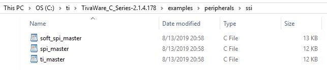

  • Hi cb1,
    I will have to ask Charles about that, he helped put the example together!
    There isn't QSSI on TM4C123x but very little difference in configuration and use for standard SSI operation. The example doesn't actually use the full QSSI functionality, I think Charles just picked that term another four letter term.
    The biggest difference is pin names for configuration are different, like these are TM4C129x specific with the name of DAT0 and DAT1 at the end (because of QSSI):
    GPIO_PA4_SSI0XDAT0
    GPIO_PA5_SSI0XDAT1
  • Hi cb1,
    As usual, Charles was right on point with the setup. The code is to show a master-slave exchange, and the master is responsible for the clock cycles.
    The MAP_SSIDataPut API is used to prepare data in the slave FIFO. It is not used to start the transmission yet. The slave must wait for the SPI CLK from the master before the shift registers will start the TX/RX. Therefore, if one were to reverse the order of those API's then the slave would see the clocks from the master before having any data prepared in the FIFO to actually send to the master!

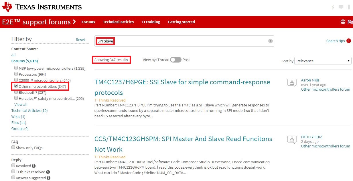

  • Hello cb1,
    Appreciate your feedback - we can adjust the comments a bit to clarify that. Comment adjustment is about the only thing we can do right now given where it is on the release process.
    There isn't a TM4C in SSI slave mode example included for this, as when we did our internal analysis on requests etc. from customers, we did not see that come up enough to make an example for it, I honestly don't even remember seeing such a request. That said, the plan is to make more examples outside of TivaWare as needed when such requests come in, and either release them via E2E or app notes for now as we wouldn't want to wait for the next update to spread more useful code around!

    Here's staff's result from our earlier search:
    In addition - a past "SPI Slave Difficulty" was resolved by a (somewhat familiar) forum member - may (also) prove instructive!
    https://e2e.ti.com/support/microcontrollers/other/f/908/t/726168?tisearch=e2e-sitesearch&keymatch=SPI%252525252520Slave
