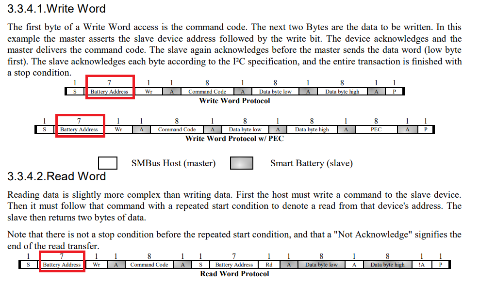

    I've asked two of my (younger) team members to, "Search w/me for the device's Slave Address" (this after they mocked me) - even after all "23 pages of review" - we could find NO MENTION of the Slave Address!
    Did you find the Slave Address - w/in this document?    If so - might you advise where?   (page number, kindly)

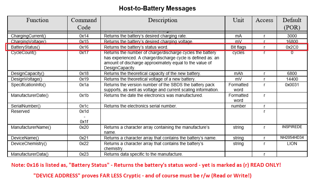

    The product is similar to ones my firm produces - and the document is nicely produced - but for the "camouflage" of the Slave I2C Address.    (We keyed on this address as it is the most likely, "Cause of your Distress.")
    Note the extract (below) the cryptic "Address" is "un-noted" w/in the timing diagram.
    It is suspected that you believe the (mystery) Slave Address to be 0x16.    We musty ask - from where did you note "0x16" as the Slave Address?
    Follows a summary of Slave Commands - yet NOWHERE is "Slave Address" (i.e. the MOST CRITICAL item) clearly listed!
    *** In the (questionable) event that "0x16" is the valid, "Battery Slave Address" - then as my earlier posts noted - it (must) be shifted left once (to make room for the "R/S" bit) which results in the (new value) "0x2C" which is to be (instead) entered as the (proper) Slave Address!    Do try entering "0x2C" instead of 0x16 - and report!

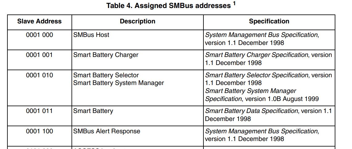

  • Hi cb1,
     I'm just as curious as you what slave address was put on the bus. The poster has yet to show the scope or LA capture of the bus. I will assume he is putting out 0001_001 or 0001_010 or 0001_011 as the slave address depending what the slave device is actually is.
  • Hi Charles,
    Staff asks, "From where did you source that "SMBus Address Listing?"
    Note that our read of his 23 pg. document revealed it to be a "Smart Battery" (almost) the equal of one's my firm produces!
    The codes you note:
    • 0001_001 denotes a Smart Charger - Not his Smart Battery   (that Battery firm produces (both) battery & charger!
    • 0001_010 we're unsure if this code is 'standard' - it is unlikely to be the Slave Address however.
    • 0001_011 as this is titled "Smart Battery" this appears the most (reasonable) Slave Address
    Now if that "0001.011x" - where x reserves the spot for placement of the I2C's R/W bit - then poster's "0x16x" WOULD signify an i2C Write - while "0x17" signifies a Read.    Should that be the case - my suggestion of the "shift Left" (creating "0x2C") would fail.
    NEVER - have any of our staff or I encountered such a "suppressed" Slave Address!   Again - from where did you source your chart?    Thanks for adding your helpful input which provides further detail - above/beyond that of poster's Smart Battery.
    *** Yet that Battery was NOT "SMART ENOUGH" to provide its Slave Address - suggest a more proper name, "Address-Less Battery!"

     I need to do some Google searches myself about SMbus for smart battery. I then come across this NXP app note. It seems to me that smart batteries have fixed address.
    nxp.com/docs/en/application-note/AN4471.pdf

    I changed the slave address to 0x0B(0000 1011), and it worked:)
    In slave address 0001 011x, "x" did not signify the R/Wr bit.
    Thank you.
