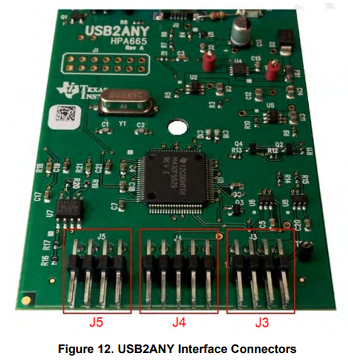

    Should you "buy into this approach" - you'll likely require a bi-directional, "USB to SPI" converter.   (of some sort - we can assist!)    This converter may be mounted upon your radio module - or (as earlier described 'this post') - upon your client's existing pcb board set - and discretely "cable or wired in" to your (existing) TM4C MCU.   (you were "clever enough" to leave one of your MCU's SPI ports as "spare" - for such situations...)
    [edit/added]: Reviewing your "Add-On design requirement further" - might the choice of a, "USB based Radio Module" - in light of the (massive) new facts gleaned/presented - warrant (some) review?   Does not an "in depth read" of this vendor's "Design Guide" (earlier presented) highlight the complexity & strict compliance which USB demands?    It must be asked - as the (real benefits) of USB are not sought - "How can a USB-based Radio Module be justified?"   Further - are such radio modules "noted" for strict compliance w/USB's many demands?   Does not the (likely) combination of (potentially) compromised USB interconnects (at EACH End) give you (proper) pause?    Should such "RISK" be invited?
    Sometimes that which is discovered to be the "hardest way" ... proves not to be the "best or most effective way..."    Team having (already) climbed that mountain - may prove optimal in aiding your climb...
    To poster (Chris) & those w/similar interest - this vendor has (also) recognized the need for a, "USB to SPI (or other serial mode) Converter."
    Young/skilled staff found & presents:
    Note that vendor - being Texas based - produced a "Texas-sized" pcb.    (the converting MCU has "80 pins" - those (possibly) more resourceful have implemented (similar) w/vastly reduced pin-count MCUs.   (Far more suitable for this poster!)   In 'fairness' to the vendor - multiple GPIO, ADC, PWM & DAC functions are included - swelling this board's size...
    Vendor's pcb (or those from others) prove ideal for "development" - then may be "Voodoo Shrunk" for production applications.   Note too that "Any" proves (somewhat) of an over-statement - "CAN" (a long recognized Serial Bus) is Not included.   (yet is - by resourceful others - somehow "USB2(Almost)ANY" does not yield the same "ring!")
