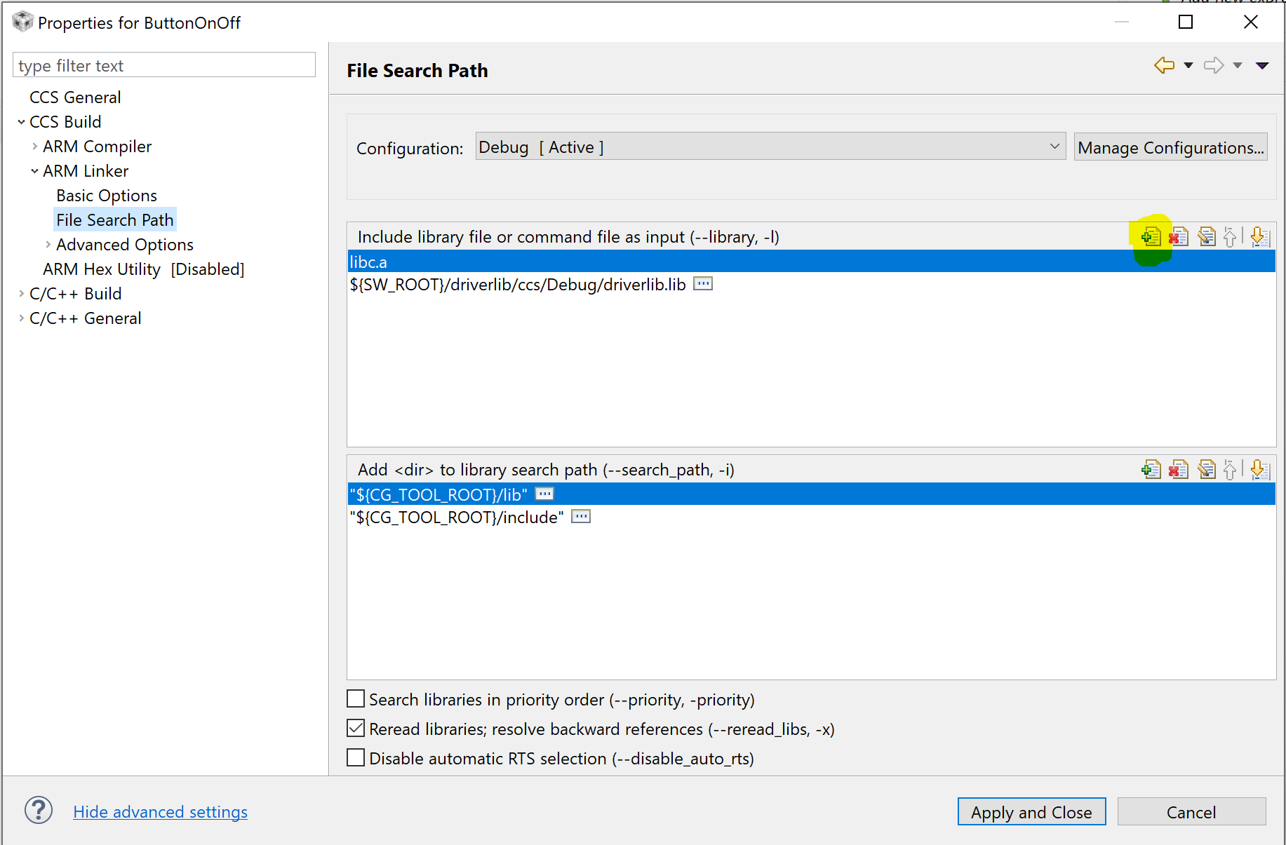

  • How can i add / import library for direct register programming in a ccs project ??
    Please tell me. It's my first time to use
  • Also when using API library??
  • To add a library to the search path of the linker for your project, right click on the project name in the Code Composer "Project Explorer" window. Then select "Show Build Settings...". A dialog box will open. Expand the selection tree "CCS Build" -> "ARM Linker" -> "File Search Path". Your dialog box should now look like the one below. You can use the "+" button highlighted in the image to add an new library to your project.
