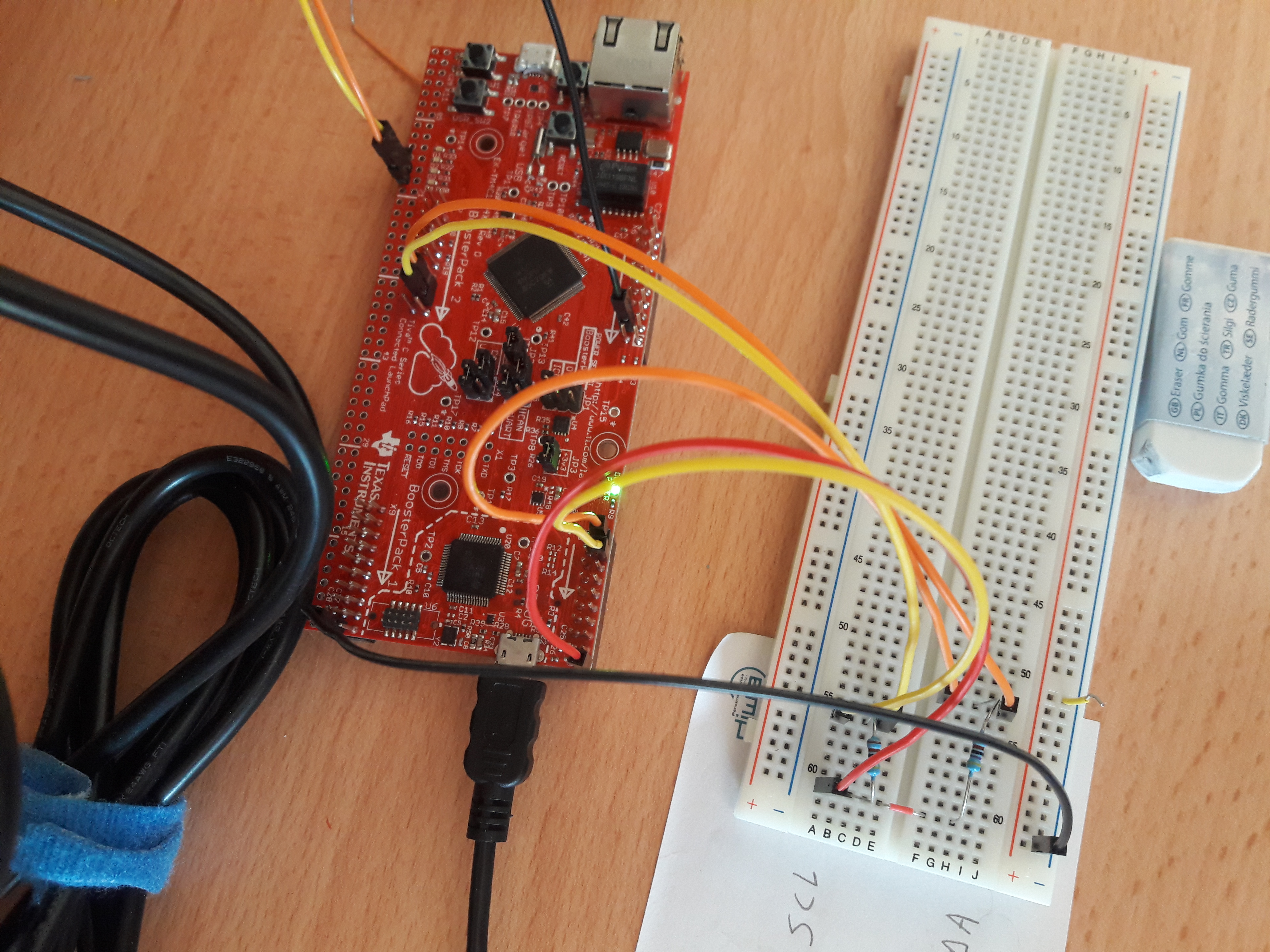

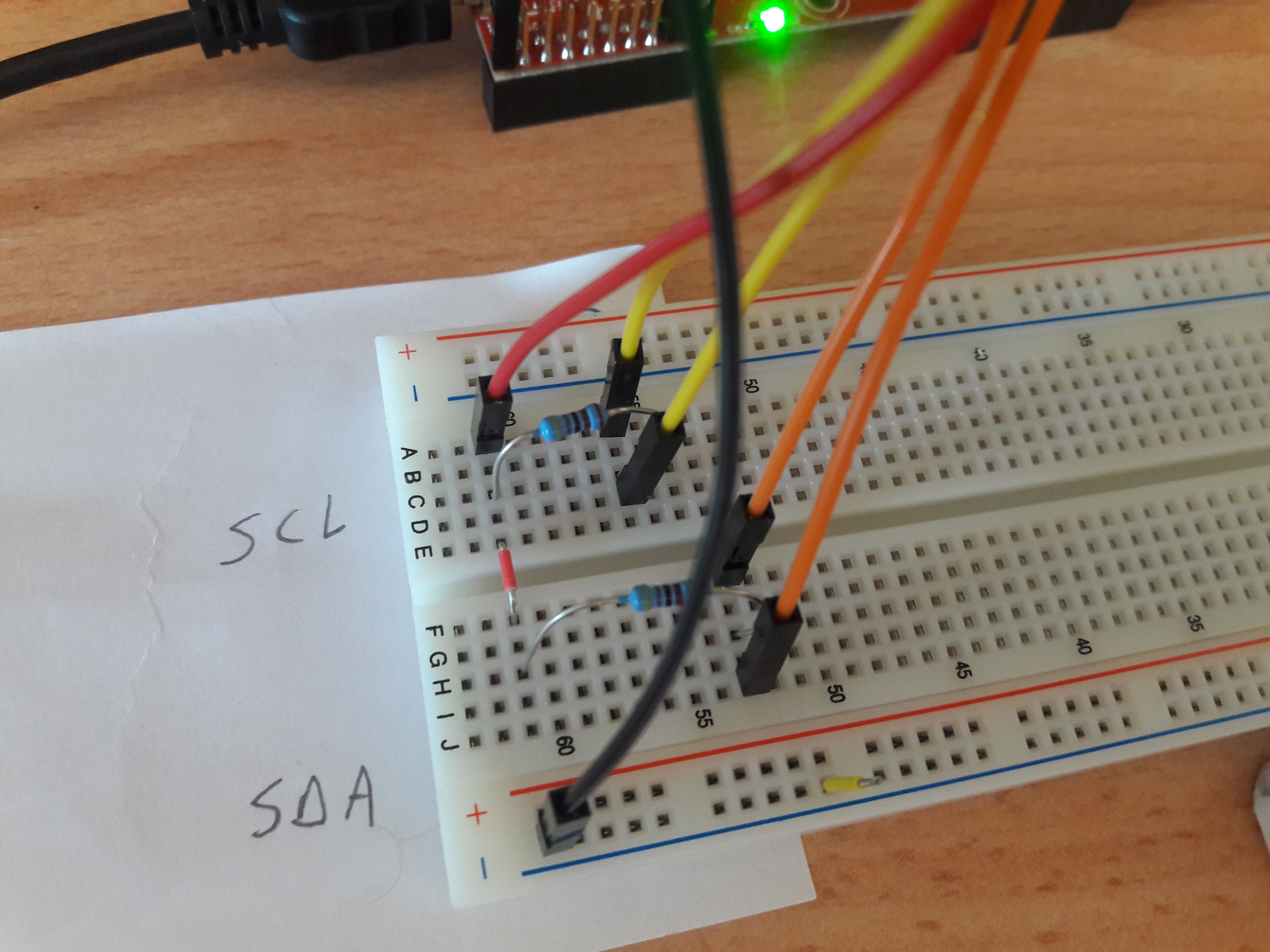

    Do I need any kind of hardware setup for this?? I have connected the SCL and SDA pins from PortB and PortK using jumper wires and that did not change anything. I do not have any other I2C devices to test
    with so my great hope is that I can share messages between 2 internal I2C ports as a first step towards a larger project.
    Thank you for any insights that you may have.

  • I don't disagree, but this is what the assignment is...so if I want to pass I just have to do it this way.
    At this point I would be happy just to have it working at all!

  • OK gentlemen. I got some resistors in today and I have an update. First, here is my hardware setup with 4.7k resistors. The red cable brings in 3.3V from the board. Yellow line is SCL, Orange is SDA:
    Now when runnuing the code, I get the master MCS as 0x30, indicating arbitration has been lost! So, that is a change and maybe now points to a software issue.  The code is the same as from a few posts back. I am reading 3.3V with my multimeter over the resistors.
    Any ideas here? I have been over the code with a fine tooth comb, and I cannot find any mistake as far as I understand the functions. I feel like I am missing something very simple.
