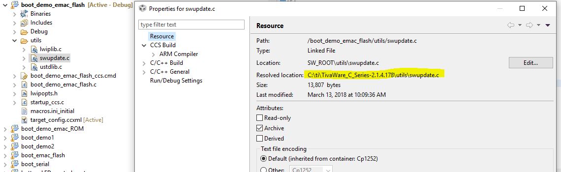

I am trying build an application based on enet_io example.  In this we also need to have field update for this project.  So I tried to copy the code from boot_demo _emac_flash. In this process I noticed that utils fplder in the project has a file swupdate.c.   However I could not copy the same to enet_io example.  Then I noticed that the same folder is empty while accessing through window file explorer but displayed in CCS.  So I  included #include "utils/swupdate.h" in enet_io.c code.
When I try to compile enet_io project I get this error
 undefined          first referenced
  symbol                in file
 SoftwareUpdateInit ./enet_io.obj
How to  solve this?
