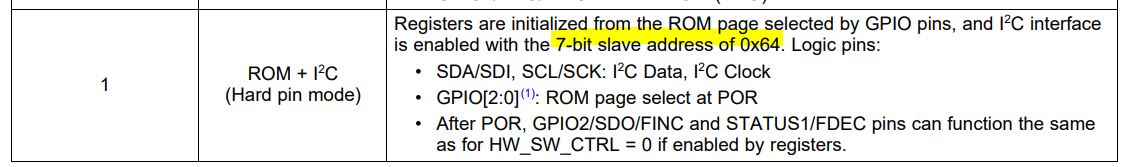

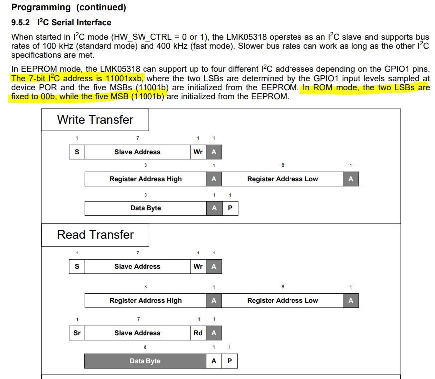

    I quickly glanced through the LMK05318 datasheet. The 7-bit slave address is 11001xx. The slave address can be 1100100 (0x64), 1100101 (0x65), 1100110 (0x66) or 1100111 (0x67). Where is the 0x78 coming from as you wrote in your code?

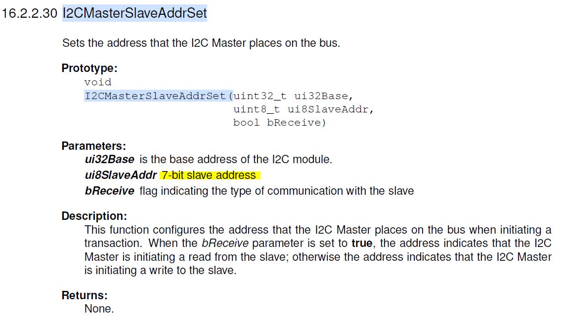

    Concerning LMK05318 address. At the beginning I thought too, based on the datasheet, that the 7 bit address was 0x64. Then, when I saw the writing sequence with the analyzer I have put 0x78 which results in 0xF0 after the shifting . This is in line with what I see in TiCS Pro Software. When I send the command "Scan I2C bus", the program returns "Device found at 0x78".  I haven't touch the EVM default configuration . This is a topic I will discuss in the LMK05318 forum.
  • HI,
      The API expects you to enter the 7-bit slave address. This is the address before the shift. So you need to enter 0x64 as far as I can tell from the datasheet. If you think 0x78 may be the correct address then you should consult with the forum that support LMK05318 to confirm. I'm not familiar enough with it.
