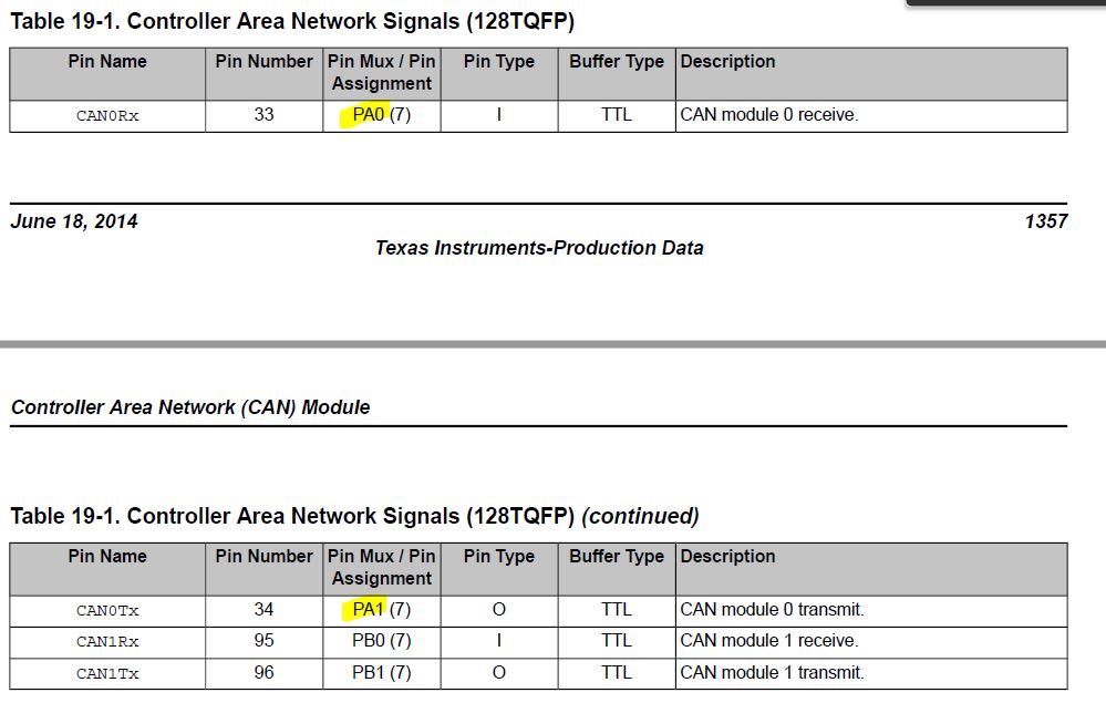

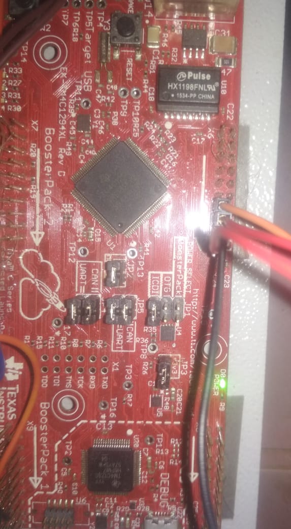

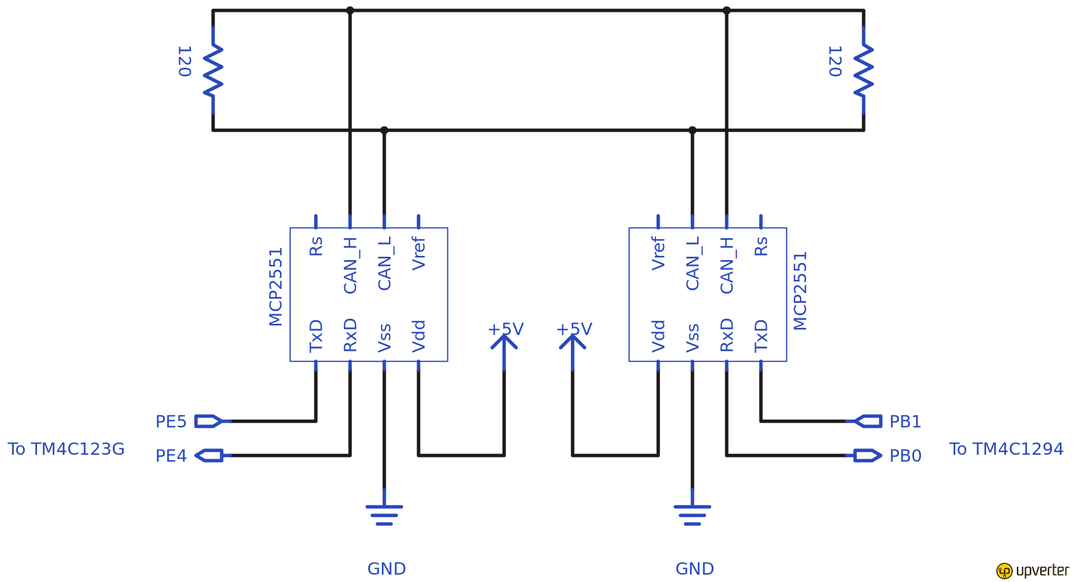

      Can you clarify what errors you are getting? Do you have the transceivers on the nodes? Do you have the scope capture or logic analyzer capture to illustrate what errors you are getting?
    In this post https://e2e.ti.com/support/microcontrollers/other/f/908/p/817657/3029826?tisearch=e2e-sitesearch&keymatch=can%25252520example#3029826, Bob uploaded the working CCS projects for both the tx and rx. You may need to make some modification to adapt to the TM4C129.
  • hi charles,

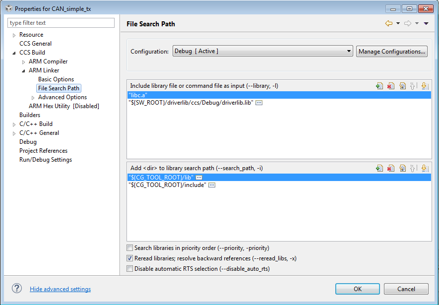

        i am using mcp2551 has transreciver i will attach my buildlog and schematic here and i am using both TM4C1294NCPDT boards
  • This is the buildlog

    error #10008-D: cannot find file "/driverlib/ccs/Debug/driverlib.lib"

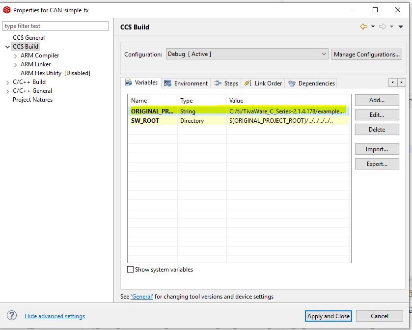

  • The below is your build errors. This means to me that you did not provide the TivaWare library. If this is the error you are talking in your original post then please add the driverlib.lib to the linker search path. See below.
     undefined              first referenced
      symbol                    in file
     GPIOPinConfigure       ./simple_tx.obj
     GPIOPinTypeCAN         ./simple_tx.obj
     IntEnable              ./can.obj
     SysCtlClockFreqSet     ./simple_tx.obj
     SysCtlDelay            ./simple_tx.obj
     SysCtlPeripheralEnable ./simple_tx.obj
  •  hello charles,
            thank you for your response my linker search path has been included driver.lib
  • It was linked earlier so no changes in my error please look into my compiler include path once
    Darshan
  • Where did you get the CAN_simple_tx project? It is missing two things. First of all, it misses the variable ORIGINAL_PROJECT_ROOT. See below after I added. Second thing is that you miss the linker command file in your project. I also added the CAN_Simple_tx.cmd
    Now it compiles fine. I will suggest in the future, you start with a TivaWare example and then modify it for your application.
    Here is the project again after adding the linker command file and the addition of the  ORIGINAL_PROJECT_ROOT. In CCS under File -> Import to import the project.

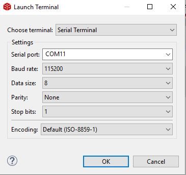

    sry for the delay there was a holiday here, i have used UART earlier to check other peripherals and printed hello world program too,
    i have set baud rate to 115200 but now i am getting some garbage value below i have attached by schematic and screenshots.
    Darshan
  • I told you in my last post to change the JP4 and JP5 to vertical position and you still miss it. Your picture still shows them in horizontal position. The reason to change the position is because by default the PA0/PA1 are used for UART0, not CAN. If you want to use CAN0 then you cannot use UART0. In order to use the COM port, you will need to change to UART2. Please refer the EK-TM4C1294XL user's guide for detail.
  • hello,
     i made mistake in selecting pins its PA0 and PA1 for can rx and can tx still uart issue not solved
    thank you,
  • Again, did you change the JP4 and JP5 to vertical position like below?
    I just run the Simple_can_rx example as is. Without connecting the CAN0 to the network, I at least see the UART message displayed.
    Also why are you connecting PB4/PB5 from the TM4C1294CPDT MCU to the transceiver? The CAN0 is on PA0 and PA1.
  • Thank you charles for  all  your response much appreciated one,
    i changed the jumpers to vertical position as u said uart2 is working fine in can_rx but i couldnt recieve data from the can_tx , so i added uart2 for can_tx to confirm whether its transmitting the data or not but uart2 doesn't seems to working in my can_rx board , so i downloaded the same can_tx program to my another slave board which i considered has can_rx  earlier where uart2 works,
    so what i am trying to say his the same project file which has uart2 function runs in one board but doesn't respond in  another board(downloading same project file)both boards configuration is same in terms of jumpers
  • So the one board where uart2 is not working i changed again jumpers to horizontal position to check whether uart0 is working even uart0 is not rseponding earlier i have run 'hello world' example in the same board for uart0 and i had got the result but now even that is not working. how can i troubleshoot this problem
    regards,
    The MCP2551 operates with Vdd at +5V.
    It says in the TM4C1294NCPDT datasheet:
    Caution – All device I/Os pins, except for PB1, are NOT 5V tolerant; voltages in excess of the limits shown in Table 27-6 on page 1820 can permanently damage the device. PB1 is used for the USB's USB0VBUS signal, which requires a 5-V input.
    Not sure if that is the cause of your problems.
    Can you try try using CAN transceivers which operate from 3.3V?
