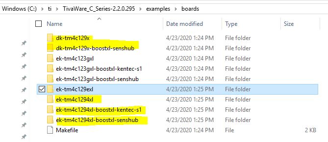

I have a EX-TM4C129EXL launch-pad board and I'm trying to get FreeRTOS running on it. My IAR IDE is using the latest (I believe) Tiva Ware 2.2.0.295 - I should be using the latest rev - right?  In that directory (under examples -> boards) there is a directory for ek-tm4c129exl, but it does not contain a FreeRTOS demo.  In fact, that is also the only launch-pad board listed.  Was 2.2.0.295 written for the ek-tm4c129exl board only?

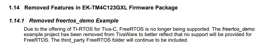

      You can use the FreeRTOS that was part of the 2.1.0 TivaWare for the EX-TM4C129EXL. I don't expect any issue using the FreeRTOS along with the latest TivaWare. It is removed from the latest TivaWare release because it is no longer supported.   Please refer to the 2.2.0 release note. https://www.ti.com/lit/ug/spmu299f/spmu299f.pdf?ts=1595198364915&ref_url=https%253A%252F%252Fwww.google.com%252F

    As explained above, it is removed from the latest release.

      You should find more examples. See below highlighted examples folders for tm4c129 other than ek-tm4c129exl. The ek-tm4c129exl has more examples for the security features.

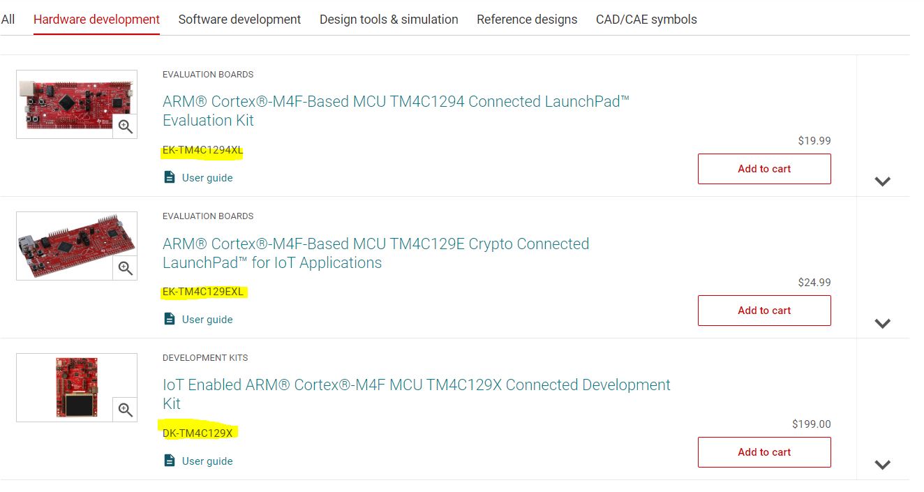

    george dorian said:
    What is the difference between "dk" and "ek" launch pad boards?
      There are three development boards with the TM4C129 processor in it that you can purchase. Go to the below website for detail. Below is an image. The DK-TM4C129x is more expensive development board. The DK board has more features (e.g. graphic display, transceiver, external memories and etc). There are separate examples under examples/boards/dk-tm4c129x folder.
