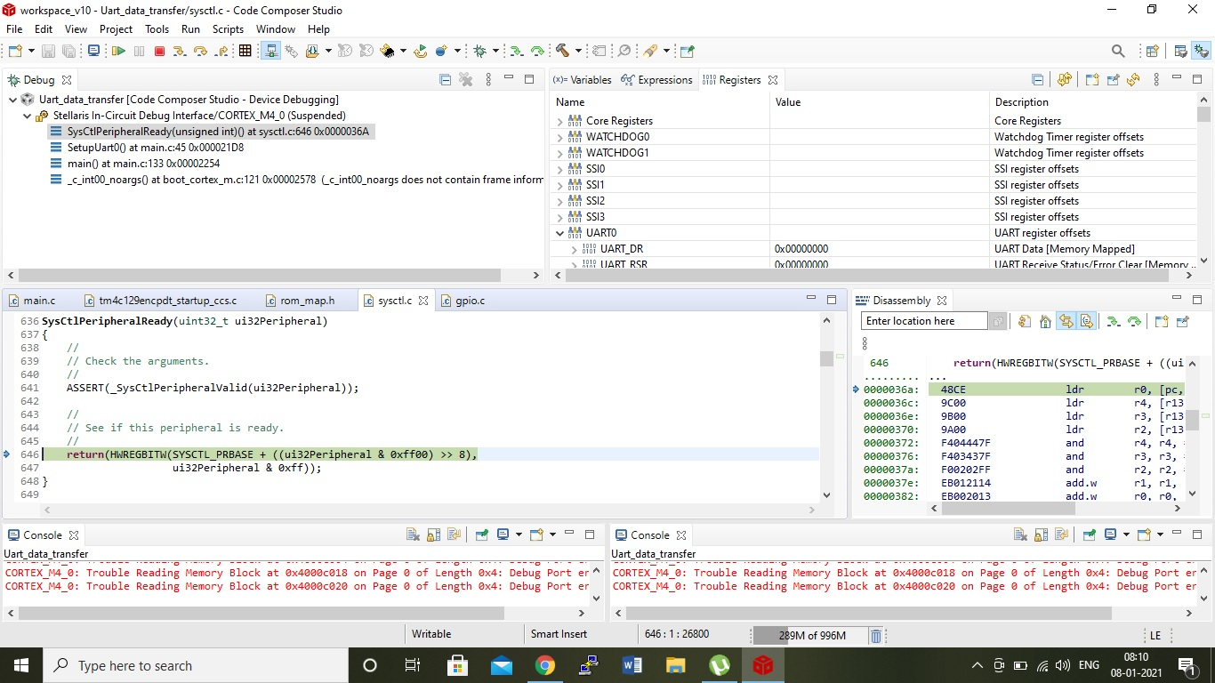

I have problem during debugging. During step execution I had problem when execute this line GPIOPinConfigure(GPIO_PA0_U0RX) ,after that execution jump into infinite loop in startup program.
which I given below...

  • I suspect your problem is that you executed the "GPIOPinConfigure(GPIO_PA0_U0RX);" immediately after enabling port GPIOA and did not give enough time for the port to be ready. You can add a while loop to wait for GPIOA to be ready.
        SysCtlPeripheralEnable(SYSCTL_PERIPH_GPIOA);
        while(!SysCtlPeripheralReady(SYSCTL_PERIPH_GPIOA))
        GPIOPinConfigure(GPIO_PA1_U0TX);
    Or, you can simply change the order of the code to allow time between enabling the port and accessing it.

  • Dear Bob Sir,
    Sorry for that actually  in Setup Uart0 I did it (). But the problem did not resolve. Please so this part is it correct?

    Execution don't come out from
    (while (!SysCtlPeripheralReady(SYSCTL_PERIPH_GPIOA))
    } ) this loop.
    I got some like that
    CORTEX_M4_0: GEL Output:
    Memory Map Initialization Complete
    CORTEX_M4_0: Trouble Reading Memory Block at 0x4000c000 on Page 0 of Length 0x4: Debug Port error occurred.
    CORTEX_M4_0: Trouble Reading Memory Block at 0x4000c004 on Page 0 of Length 0x4: Debug Port error occurred.
    CORTEX_M4_0: Trouble Reading Memory Block at 0x4000c018 on Page 0 of Length 0x4: Debug Port error occurred.
    CORTEX_M4_0: Trouble Reading Memory Block at 0x4000c020 on Page 0 of Length 0x4: Debug Port error occurred.
    How can I resolve this issue.

  • Actually, there are several things wrong with your code. It looks like you took a working example and made changes. When that did not work, you made more changes.
    The first thing wrong is you used the wrong parameter when you enabled the clocks to GPIOA. It should be:
    Not:
    SysCtlPeripheralEnable(GPIO_PORTA_BASE);
    You have several unnecessary UART calls, but then call UARTStdioConfig() with the wrong frequency value.
    I suggest you go back to this example in TivaWare and start from there.
    C:\ti\TivaWare_C_Series-2.2.0.295\examples\boards\ek-tm4c129exl\hello
