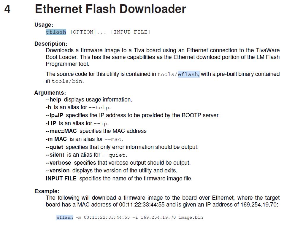

      I don't know the reason. Let's make sure it is an issue with the LM flash programmer and not something with the how you capture wireshark or some network issue. Can you do an experiment? Run the TivaWare example boot_emac_flash. This is the flash-based ethernet bootloader. The flash ethernet bootloader also waits for the magic packet from the LM flash programmer if you have the correct IP address and MAC addresses. Do you see the magic packet sent by the LM flash programmer?
      Also try the eflash.exe which is a command line version of the LM flash programmer for flash downloader.
