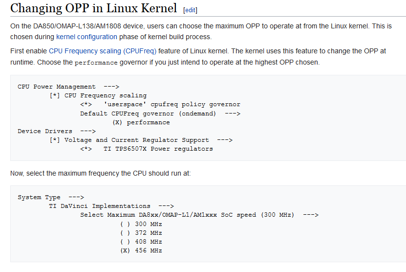

    2, The AM1808 chip max freq is 456M . The cpuinfo_max_freq(300M) is the configured maximum OPP to operate from the Linux kernel, right? If yes, how to understand chip current running freq cpuinfo_cur_freq(384M) is larger than maximum OPP cpuinfo_max_freq (300M)? We  will  check and configure maximum OPP to operate as 456M from the Linux kernel then to see the result.
    3,   How should we do to change the MAX?For example, to make CPU work in max freq,  Below are 3 methods we will try and any comments are welcome,
    a."# echo 384000 > /sys/devices/system/cpu/cpufreq/policy0/scaling_min_freq"
    b. choose the maximum OPP to operate at from the Linux kernel
    c.  u-boot> setenv maxcpuclk 456000000

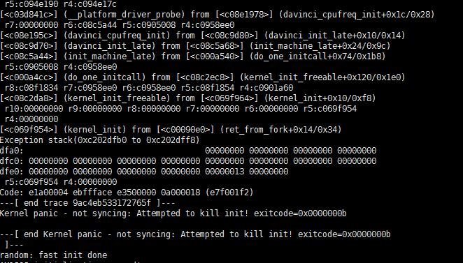

    b,u-boot> setenv maxcpuclk 456000000
    after enter u-boot and setenv maxcpuclk 456000000,then when use bootm command,it failed to load kernel (stop after init random )as follow:

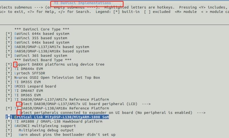

    c. choose the maximum OPP to operate at from the Linux kernel
    I just configure the kernel like this:
    but I cannot find Select Maximum option after second step( ti-processor-sdk-linux-omapl138-lcdk-06.03.00.106 SDK):
    Thanks very much.
