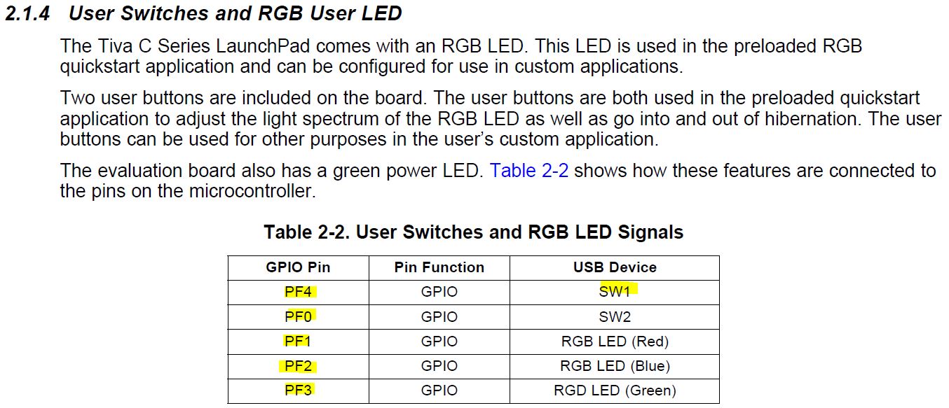

    Just one more comment on your above code, you are trying to blink LED on PA2 and use the same PA2 as a SW1? This is again very confusing. What are you trying to do? This will not work.
    Finally, if you are using the EK-TM4C123GXL launchPad board then the the SW1 on the board is connected to PF4, not PA2. The LED are mapped to the PF port, not PA port.

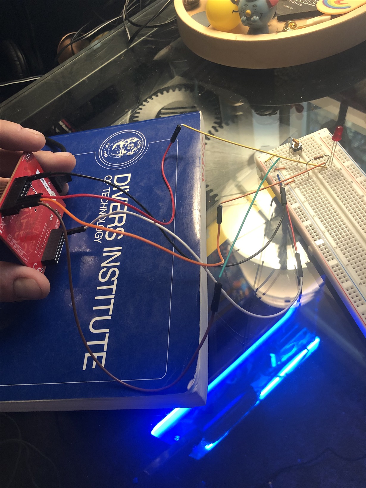

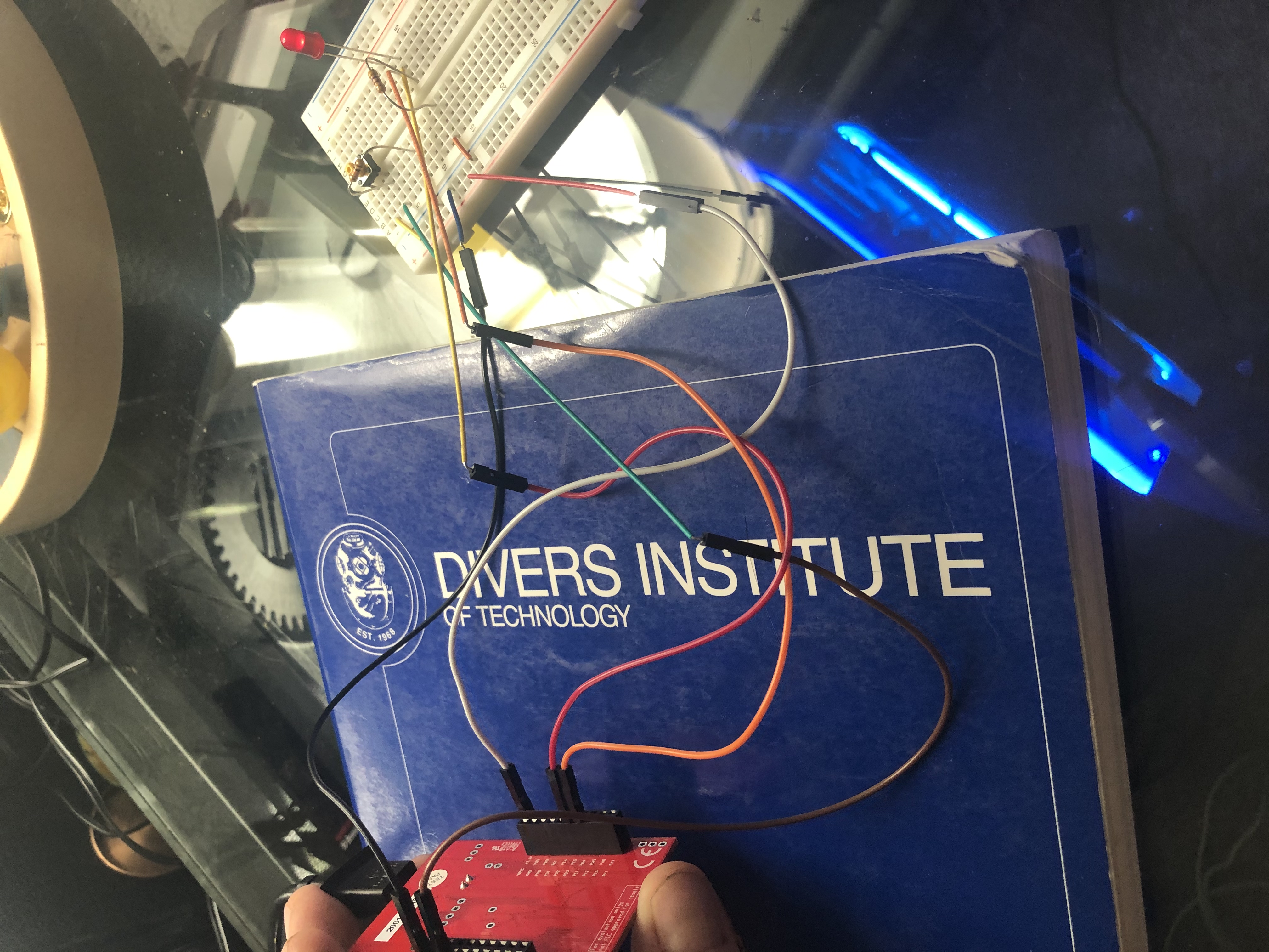

  • Hello Charles!
    Take a look at this wire setup (hopefully it showcases how I am using PA2 for external bounce switch on the protoboard and PA3 for the LED).
    Specifically I do not understand if this is correct address/code to turn on the clock for PORT A
    //#define SYSCTL_RCGC2_GPIO_R (*((volatile unsigned long *)0x00000001)) // port A Clock Gating Control
    or if I need to fix something on this line
    //SYSCTL_RCGC2_R |= 0x00000001; // 1) activate clock for Port  A

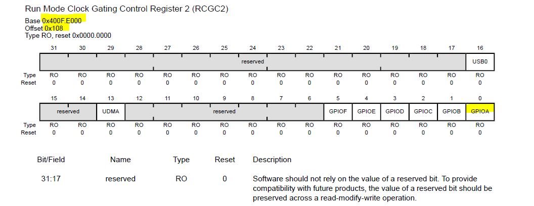

      You wrote in your first post:
    #define SYSCTL_RCGC2_R (*((volatile unsigned long *)0x400FE108))
    Your SYSCTL_RCGC2_R is mapped to address 0x400FE108 which is correct. You should write a 0x1 to this register to enable the clock to the GPIO PortA.
     What is the SYSCTL_RCGC2_GPIO_R? You are mapping it to address 0x00000001. This is the second byte of the flash memory. This is incorrect.
