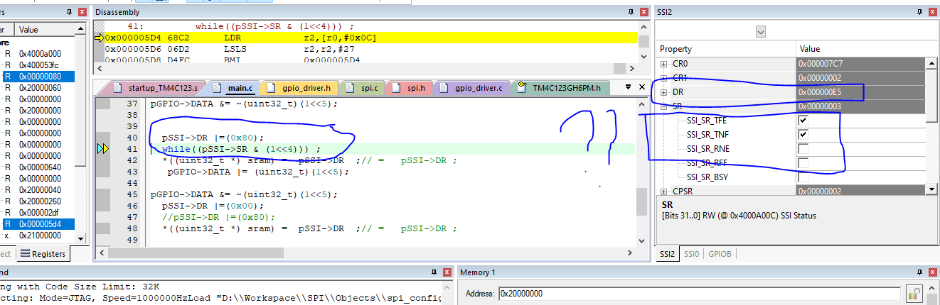

hi , i am building my own spi drivers i am using micro vision
every time i write to the DR register the data is sent correctly and the desired received data is written in the DR register (i know because it appears in the debugging mode)
when i try to get that data into a variable it reads zero
my  code

      First of all, please refer to note #4 in this FAQ https://e2e.ti.com/support/microcontrollers/other/f/908/t/695568. Basically, we do not support DRM style of coding as it is very prone to mistakes. We provide TivaWare library with proven APIs to develop your application. Please use the TivaWare or at least look at the source code of the APIs on how they are coded to read the SPI FIFO.
      With that said, I think the a likely problem is that there are residual data already in the RXFIFO and you are reading the residual data instead of the real data. What you want to do is like this.
      1. Flush the RXFIFO by reading all the data in the RXFIFO until the RXFIFO is empty.
      2. Send your data
      3. Read your data
