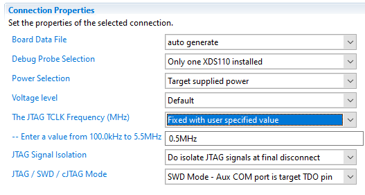

We have custom designed board using an MSP432 controller. The first board has worked fine and I am trying to get a second board up and running. Same board but this one doesn't connect using the XDS110 probe. I get the error:
Error connecting to the target:
(Error -613 @ 0x0)
The target indicates that it is busy. Either try the SWD request
again, or abort the transaction.
(Emulation package 9.2.1.00042)
I know it's not a design or configuration error because the first board worked. There's very little hardware between the JTAG connector and the processor. Here's the circuit:
This is the connection properties from the .ccxml file:
I've tried different clock frequencies and the different JTAG modes.
At this point I suspect the problem is in the processor but I'd like to confirm it before resorting to replacing the processor. Is there anything else I can try?
Andrew

  • Hi Gary,
    This hardware is working on one board and not working on 2 other boards. I do not think the pull up resistors are the problem.
    I get the message:
    (Error -613 @ 0x0)
    How does the target indicate it is busy?
    Andrew
  • This problem was traced to a loading error. One of the capacitors around the external crystal was the wrong value. This stopped the crystal from running. The  thread  explains why this kills the JTAG/SWD comms.  The test software I loaded after the first connect starts by switching to the external crystal as the clock source. Might have to add a check to see if the external crystal is running...
