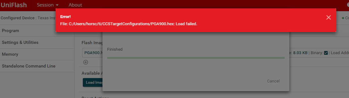

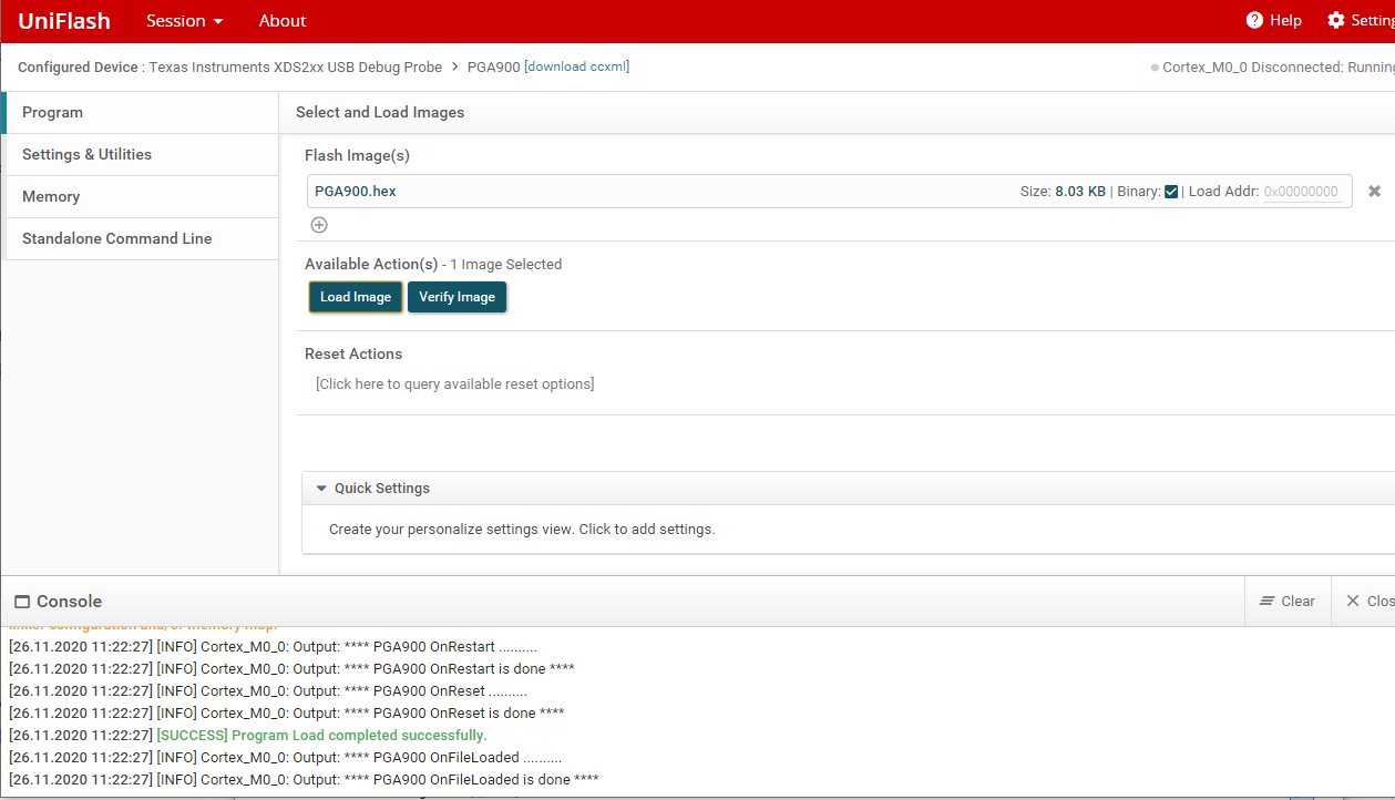

I Program the PGA900 with Uniflash and there comes no Errors.

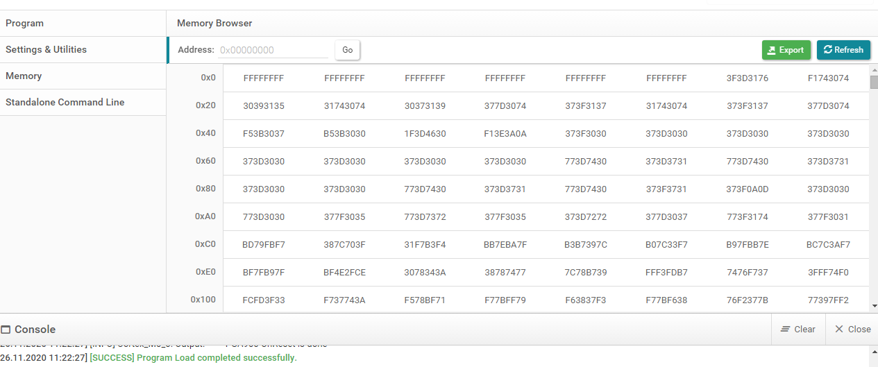

When I look at the memory map, it doesn't contain the desired content
when I do a Verify I get the following error message:
The 7.5V programming voltage is present and the REMAP bit is deleted:
Here are my Files:
