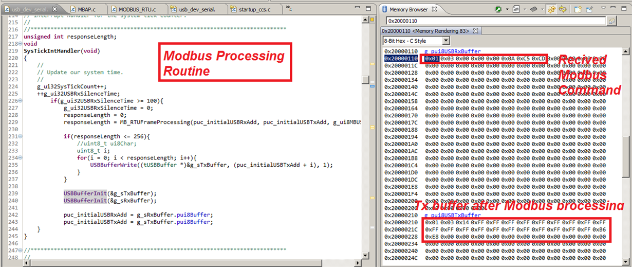

We have modified the example of usb_dev_serial to interface with host PC using Modbus, we are receiving modbus commands and processed it then update the USB Tx buffer, but there are no data get transmitted on the USB of board to host PC, is there any step we miss to ask the MCU to transmit the data?????
  • Hello Hani,
    I am not familiar with Modbus protocol so I cannot offer advice specific to the protocol itself, but couple things of note I see:
    1. You are using this in SysTickHandler and that may be a an issue here because you may be getting stacked interrupts I would not use SysTick for so much handling. Set a flag inside of it and execute your code via main.
    2. I don't fully understand your logic here of using USBBufferWrite's followed by then doing USBBufferInit?? Do you mean to maybe Flush the USB buffers? There are APIs for that...
                USBBufferFlush(&g_sTxBuffer);
                USBBufferFlush(&g_sRxBuffer);
    As for what is missing with your TX setup, I don't see enough of the USB setup code to comment.
  • Dear Ralph
    I used the two above recommendations, transferred the Modbus processing routine in the main and used the USB buffer flush, but there are no data get transmitted to host PC. So i attached you copy of the USB setup code.
    Note: for the code of USBBufferInit, I use it to force the USB controller to go to beginning pointer of Rx buffer every time MCU receive new Modbus command and not to proceed with ring buffer.

  • Hello Hani,
    Can you please post the code as a .c file? I can't use the PDF with my comparison tools.
  • Here it is

                if(responseLength <= 256){
                    //uint8_t ui8Char;
                    uint8_t i;
                    for(i = 0; i < responseLength; i++){
                        USBBufferWrite((tUSBBuffer *)&g_sTxBuffer, (puc_initialUSBTxAdd + i), 1);
                USBBufferInit(&g_sTxBuffer);
                USBBufferInit(&g_sRxBuffer);
                puc_initialUSBRxAdd = g_sRxBuffer.pui8Buffer;
                puc_initialUSBTxAdd = g_sTxBuffer.pui8Buffer;
