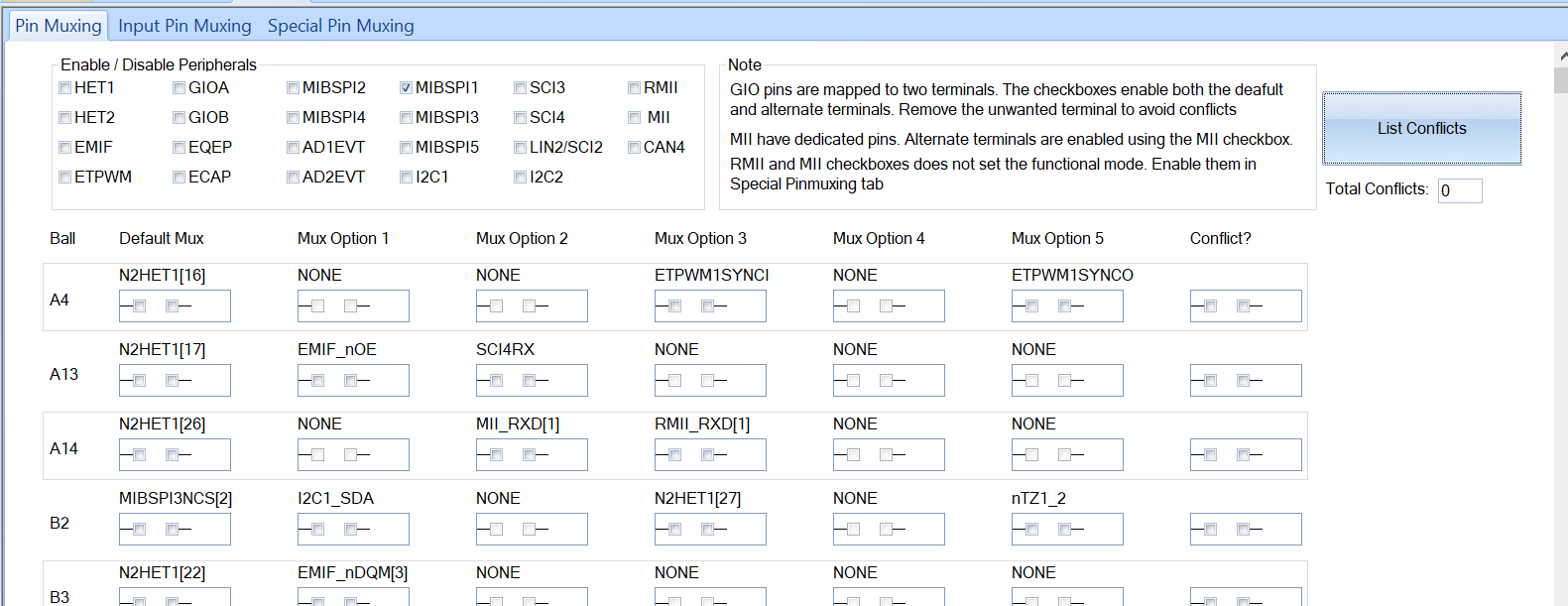

    Halcogen Seeting:
    And the Mibspi1 setting is as per the Haclogen Help example in "Example_mibspiDma.c"
    please let me know or suggest /provide me any code example in loopback mode - SPIDMA

  • Hello QJ Wang,
    I have added the mibspiEnableGroupNotification(mibspiREG1,0u,1u); and enable the MIBSPIx interrupt both, High and low in Halcogen,
    find the code and Halcogen Setting, Please let me know is there is anything i missed or Is there is any example to try,
