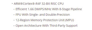

  • Hello George,
    I checked TMS570LS2124 - 16/32 Bit RISC Flash MCU, Arm, In the data sheet it's mentioned as
    Which mentioned it has FPU unit but my operations are going wrong, Can you please help me in this regard

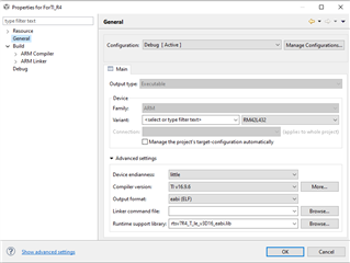

  • There were several issues with your project. First it was configured for a RM46L842 instead of a TMS570LS1224. Then it was missing all of the initialization files. I corrected these issues and ran the code on an XL2-TMS57012 launchpad. I have attached the modified project in a zip file. The values I got were:
    f32EqShortCut float 1.96798356e-41
    DETC_f32VelocityResolutionUmps double 0.22407472133636475
    4073.ForTI_R4.zip

  • What version of Code Composer Studio are you using? What hardware are you attached to?
  • You mentioned a simulator. The very old ARM Cortex R4 simulator did not support the floating point hardware. The processor in the TMS570LS1224 is a Cortex R4F (the F means with floating point hardware). I suggest you purchase a XL2-TMS57012 launchpad and download the latest version of CCS for development work.
